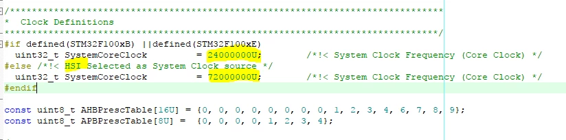

This function which is called at the entry of Main() function(Code generated by cubeMX) can not initialize systick timer to create 1ms time intervals correctly. As a result if functions which are called after HAL_Init() use HAL_GetTick() for delay or wait purposes fail to work as programmer expect.
It is true until SystemClock_Config() function  (which itself trust on HAL_GetTick()  for some initializations wait time)  modify systick timer.
The reason is that for initialization of systick timer HAL_InitTick() function use the value of �SystemCoreClock� variable which is not updated yet.

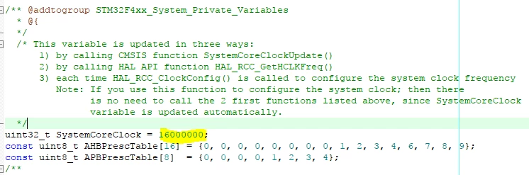

Inside system_stm32xxxx.c there is the definition of SystemCoreClock variable which takes the value of the default core clock frequency after power on (HSI , MSI ...)
This value of SystemCoreClock used to initialize the SysTick inside
HAL_Init()  function.
SystemClock_Config()  reinitializes the SysTick with the updated value of SystemCoreClock .

Thanks for reply. Actually I meant to say that the initialization of “SystemCoreClock�? is wrong.

While in new version of “system_stm32xxxx.c�? (one which is used in CubeMX) the above
definitions are truncated to :
#if defined(STM32F100xB) ||defined(STM32F100xE)
 uint32_t SystemCoreClock = 24000000; /*!< System Clock Frequency (Core Clock) */
#else /*!< HSI Selected as System Clock source */
 uint32_t SystemCoreClock = 72000000; /*!< System Clock Frequency (Core Clock) */
#endif
As a result at startup that system clock is HSI (8 MHz) and no setting is done inside “SystemInit()�? (absence of “SetSysClock()�? function) the clock is wrongly assumed as 72MHz.

For sure i agree with you about this for F1 firmware used in CubeMx
Also my yesterday's answer concerned  L1 and F4 families that have the correct HSI , MSI values.
The conclusion is
The values inside file system_stm32f1xx.c must be revised from ST team , to have correct generated code by CubeMx.
