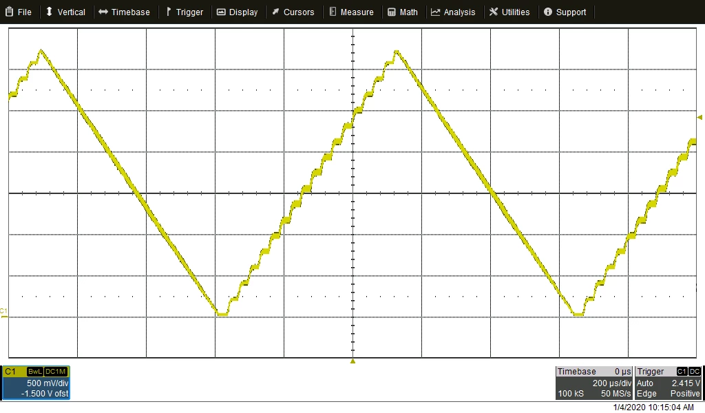

OK, below are the parts of the original appnote code which were somehow modified...

note - I was not sure what is the magic of using ((uint16_t*) aDitherTable when the array was defined as uint32_t aDitherTable[16]... so I used uint32_t...

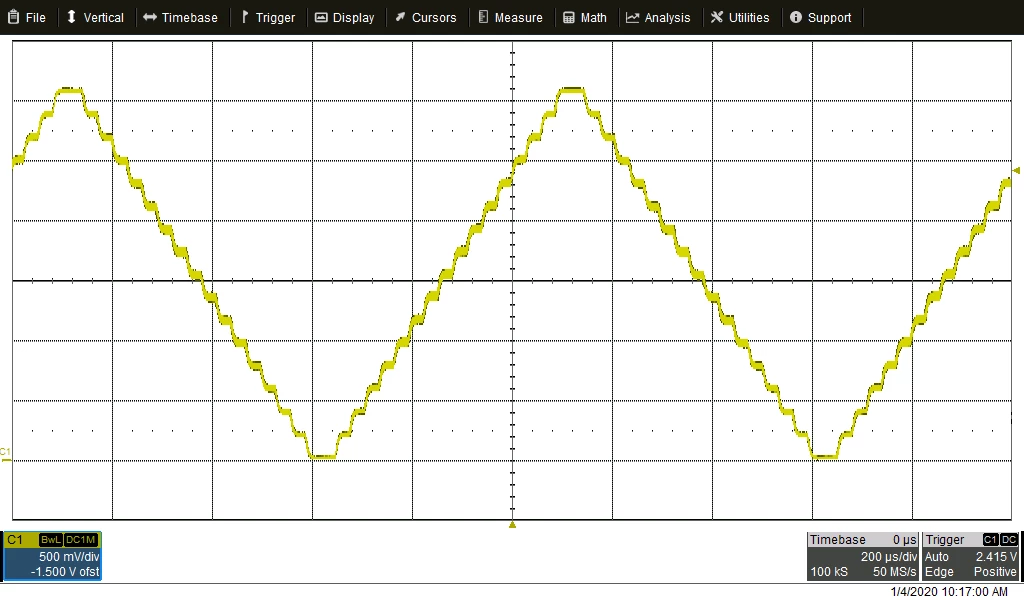

output when there is "DitherIndex" supplied to the function "UpdateDitherTable" at AA, BB, CC, DD places.

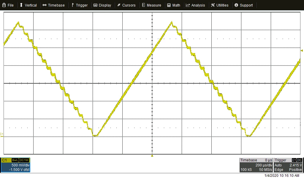

output when "0" placed instead of DitherIndex for AA and CC
output when "0" placed instead of DitherIndex for BB and DD

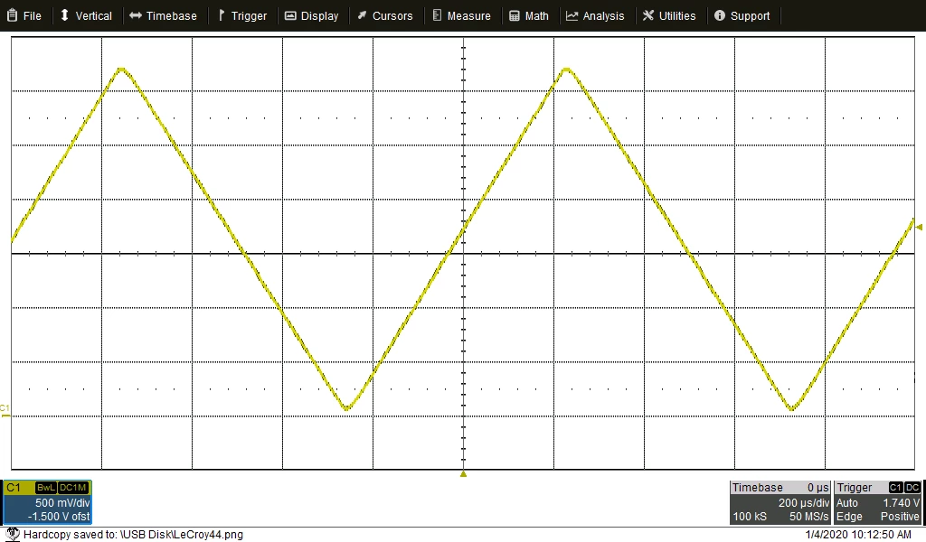

output when "0" placed instead of DitherIndex for AA,BB,CC and DD
