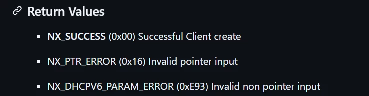

Actually if parameter
packet_pool_ptr: Pointer to Client packet pool
does not point to a packet pool ( as when the variable has been defined but not initialized ), the functions does not returns NX_DHCPV6_PARAM_ERROR (0xE93) Invalid non pointer input but NX_SUCCESS (0x00) Successful Client create.
As for every discrepancy between reference manual and actual code, could be that manual is inaccurate, but in this case it is mandatory to edit ASAP with correct wording.

Hello @mbarg.1 ,
Just wanted to point out that as per the NetX documentation in GitHub implies:
"In the "Return Values" section in the following API descriptions, values in BOLD are not affected by the NX_DISABLE_ERROR_CHECKING define that is used to disable API error checking, while non-bold values are completely disabled."
and since only NX_SUCCESS is in bold and other return values are not those two are completely disabled.
just wanted to know how you are passing the uninitialized pointer to this function and are you sure NX_DISABLE_ERROR_CHECKING is not activated?
also, I want to point to you that issues related to Nextduo documentation should be input in Issues · eclipse-threadx/netxduo

I can confirm - because I did this very same mistake of forgetting to initialize packet pool - that IF packet_pool_ptr is not NULL, but data inside are all zero (non initialized pool)  you get NX_SUCCESS (0x00) - NX_DISABLE_ERROR_CHECKING not activated.
Have a look at code below:
packet_pool_ptr is tested only for NULL ptr value in _nxe_dhcpv6_client_create()
and assigned to dhcpv6_ptr -> nx_dhcpv6_pool_ptr in _nx_dhcpv6_client_create().

/* Set the callback function to detect DAD process.
If DAD failure, automatically set event to send DHCP decline meessage.
Notice: other modules should not set the address change notify function again. */
status = nxd_ipv6_address_change_notify(dhcpv6_ptr -> nx_dhcpv6_ip_ptr, _nx_dhcpv6_ipv6_address_DAD_notify);
/* Was the callback notify fucntion creation successful? */
if (status != NX_SUCCESS)
/* Delete the timers. */
tx_timer_delete(&(dhcpv6_ptr -> nx_dhcpv6_IP_lifetime_timer));
tx_timer_delete(&(dhcpv6_ptr -> nx_dhcpv6_session_timer));
/* Delete the mutex. */
tx_mutex_delete(&(dhcpv6_ptr -> nx_dhcpv6_client_mutex));
/* Delete the flag queue. */
tx_event_flags_delete(&dhcpv6_ptr -> nx_dhcpv6_events);
/* Delete the thread. */
tx_thread_delete(&dhcpv6_ptr -> nx_dhcpv6_thread);
nx_udp_socket_delete(&(dhcpv6_ptr -> nx_dhcpv6_socket));
/* No, return error status. */
return status;
#endif
/* Keep the DHCPv6 instance for DAD callback notify. */
_nx_dhcpv6_DAD_ptr = dhcpv6_ptr;
/* Return a successful status. */
return(NX_SUCCESS);
Jan 27, 2025 2:05 PM UTC
Hello @mbarg.1 ,
This seems to be valid to me if the pointer is declared and uninitialized this will return success assuming that the pointer was declared with value different than NULL so I suggest that you declare the pointer to a NULL value, and it should then catch the error and as suggested before this should be input  in Issues · eclipse-threadx/netxduo as this is not ST documentation and source code but eclipses open-source code.
Regards
