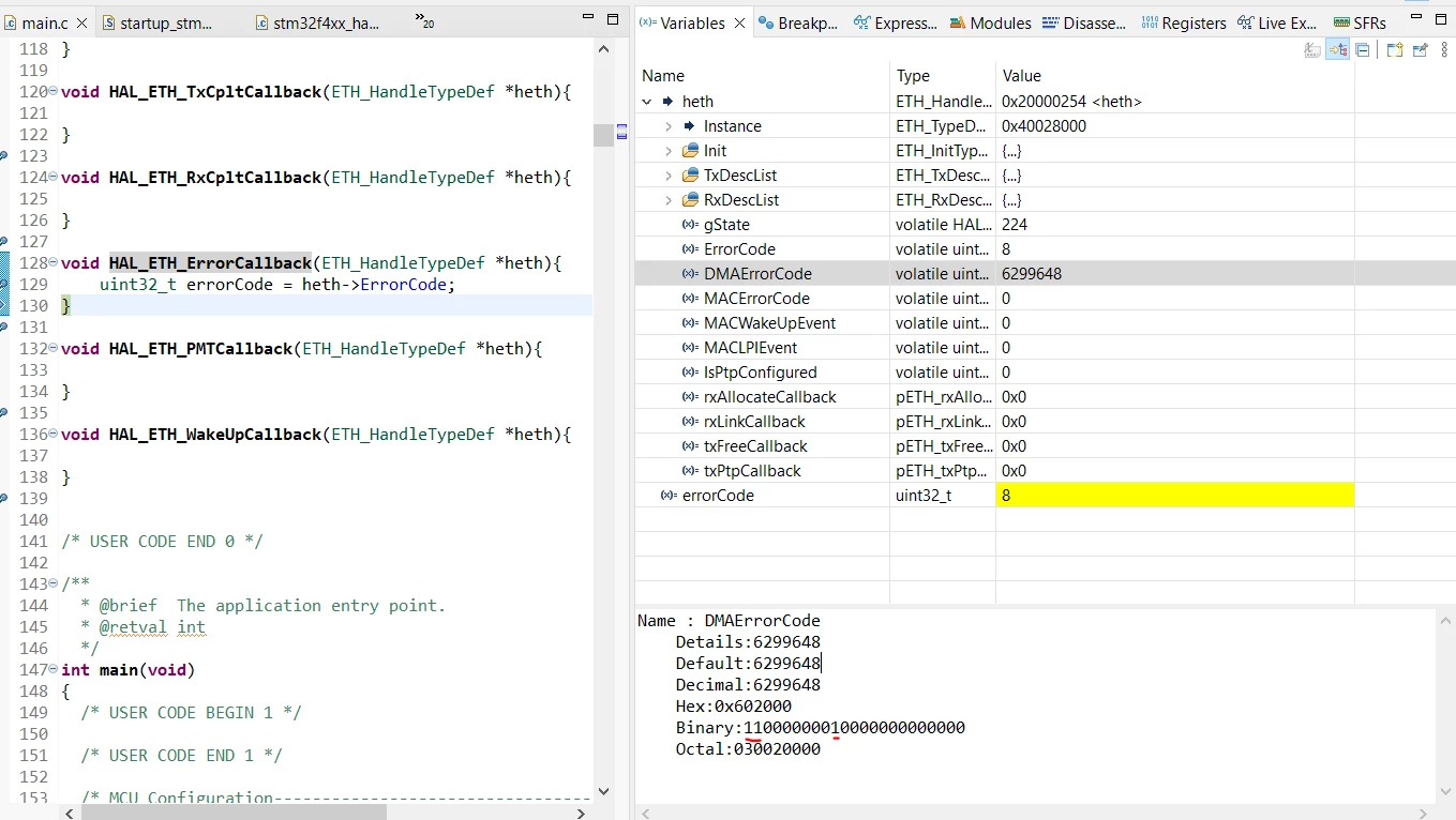

BUG: DMA Fatal Error - Ethernet in STM32F407 processor
Hi!
Problem:
I found a bug when I enabling the ETH perpherial in the STM32F407 processor. The error is a DMA bus error.
What's happening:
It occurs when the ethernet PHY recieve a message from my router.
How to produce the error:
I do the following steps to reproduce the error.
  1. I start up my PCB board
  2. I let the initialization do its job and I get no error back.
  3. I plugin my ethernet cable
  4. I ping a random device with a random number
Then this call back function HAL_ETH_ErrorCallback(ETH_HandleTypeDef *heth); will be called.
0693W00000LyBzOQAV.pngThe error code is a DMA error.

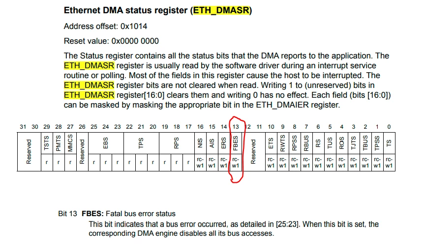

The DMA error is a DMA bus error.
0693W00000LyC0HQAV.pngThis part of the code creates the DMA error code. See the arrow <---- HERE!
/* ETH DMA Error */
 if (__HAL_ETH_DMA_GET_IT(heth, ETH_DMASR_AIS))
 if (__HAL_ETH_DMA_GET_IT_SOURCE(heth, ETH_DMAIER_AISE))
 heth->ErrorCode |= HAL_ETH_ERROR_DMA;
 /* if fatal bus error occurred */
 if (__HAL_ETH_DMA_GET_IT(heth, ETH_DMASR_FBES))
 /* Get DMA error code */
 heth->DMAErrorCode = READ_BIT(heth->Instance->DMASR, (ETH_DMASR_FBES | ETH_DMASR_TPS | ETH_DMASR_RPS)); <<--- HERE!
 /* Disable all interrupts */
 __HAL_ETH_DMA_DISABLE_IT(heth, ETH_DMAIER_NISE | ETH_DMAIER_AISE);
 /* Set HAL state to ERROR */
 heth->gState = HAL_ETH_STATE_ERROR;
 else
 /* Get DMA error status */
 heth->DMAErrorCode = READ_BIT(heth->Instance->DMASR, (ETH_DMASR_ETS | ETH_DMASR_RWTS |
 ETH_DMASR_RBUS | ETH_DMASR_AIS));
 /* Clear the interrupt summary flag */
 __HAL_ETH_DMA_CLEAR_IT(heth, (ETH_DMASR_ETS | ETH_DMASR_RWTS |

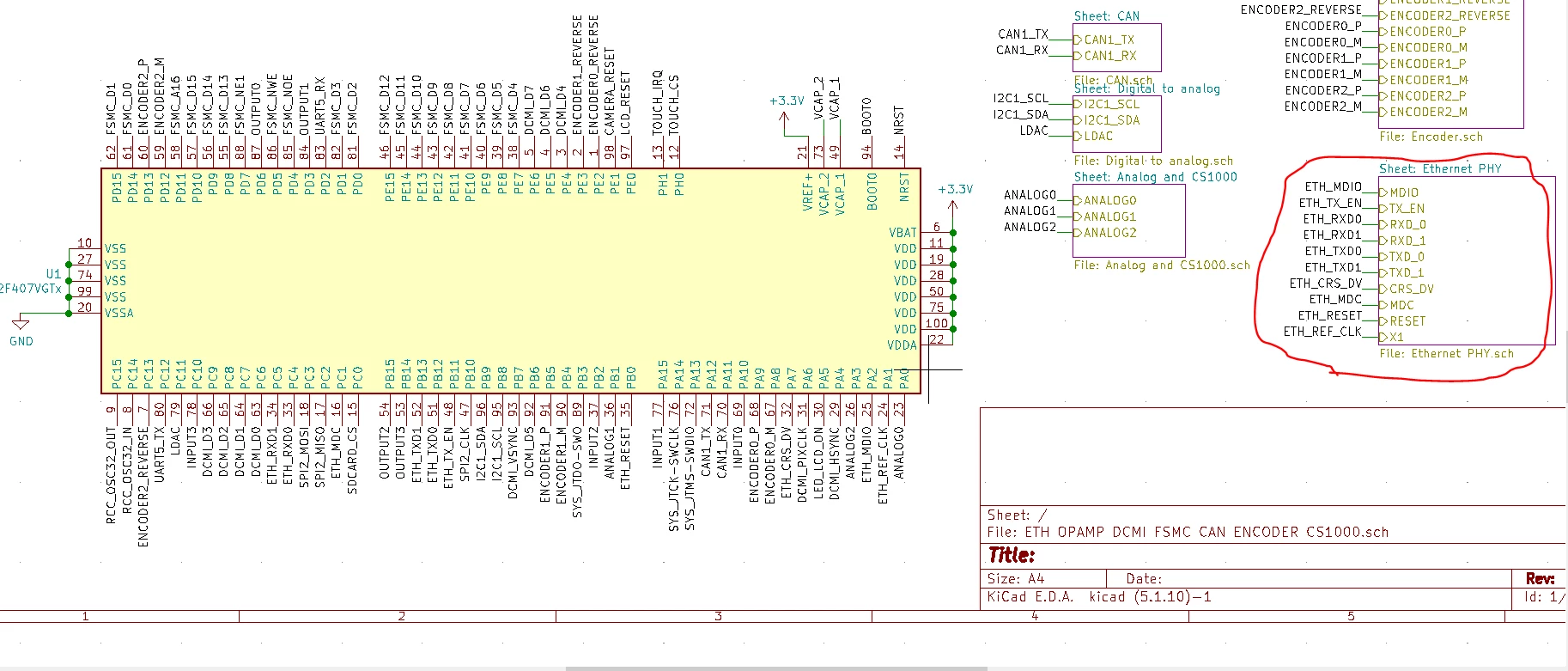

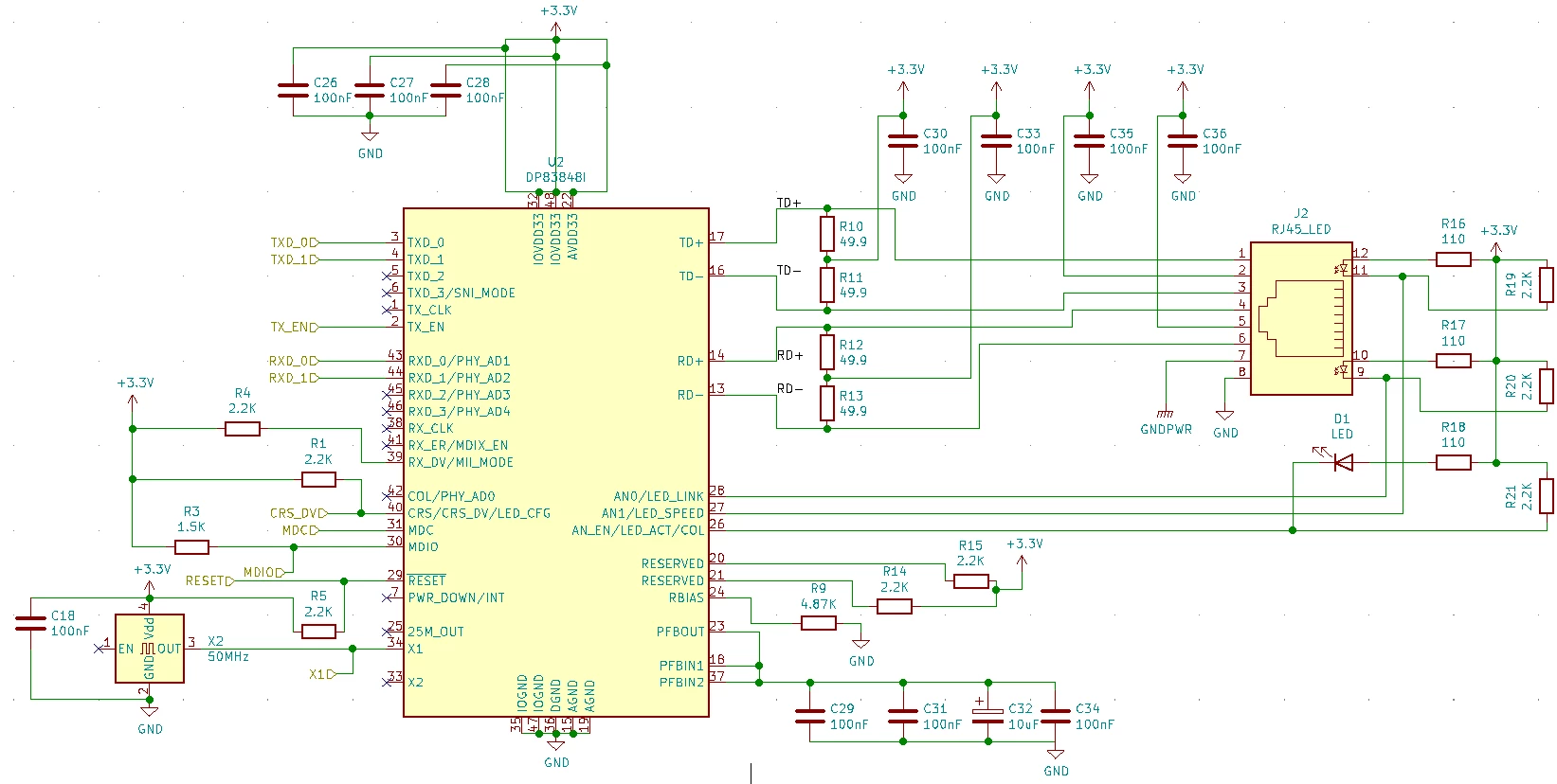

Hardware settings
The hardware settings are for RMII for the Ethernet PHY DP83848 .
Yes! The LED D1 flashes when something happen at the network. The pin ACT_LED/COL should go low when something happens. The oscillator is at 50 MHz and very close to the DP83848 chip.

What am I 100% sure that I have been constructed the hardware correctly?
The Ethernet PHY address is 0x1 and I have been veryfied that this is correct address. The LED D1 is flashing when activity occurs at the network.
The callback function calls when the LED D1 flashes after initialization.

Pavel A.
Apr 19, 2022 7:55 PM UTC
Your hardware likely is good, because it seems to "do something" when the cable is connected.
But the software obviously has issues.
> Because I have not configured ETH DMA
ETH has its own DMA master. It does not use DMA controllers of STM32. This DMA starts when you call HAL_ETH_Start_IT.
Again: your code does not assign RX buffer memory to the descriptors. So the ETH DMA fails. What else can it do.
