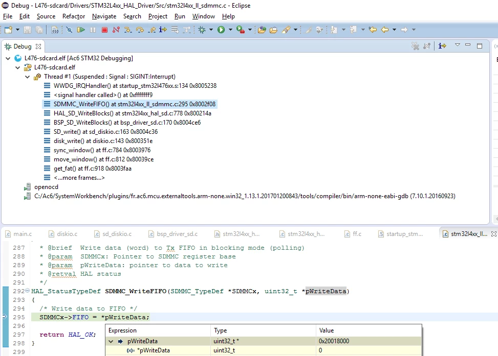

I'm trying to get a SD-Card working with FATFS on a NUCLEO-L476RG. Code was generated with recent STM32CubeMX 4.0 and Firmware Package 1.8.0 for L4. SD-access in polling mode, no DMA.
My application was crashing (Default_Handler, Infinite_Loop) while writing to the card. The crash was happening instm32l4xx_hal_sd.c in HAL_SD_WriteBlocks(), here:
/* Write block(s) in polling mode */
 while(!__HAL_SD_GET_FLAG(hsd, SDMMC_FLAG_TXUNDERR | SDMMC_FLAG_DCRCFAIL | SDMMC_FLAG_DTIMEOUT | SDMMC_FLAG_DATAEND))
 if(__HAL_SD_GET_FLAG(hsd, SDMMC_FLAG_TXFIFOHE))
 /* Write data to SDMMC Tx FIFO */
 for(count = 0U; count < 8U; count++)
 SDMMC_WriteFIFO(hsd->Instance, (tempbuff + count));
 tempbuff += 8U;
After a crash, (tempbuff + count) has the value 0x20018000 (see attachment). This seems to be a invalid address which is not in RAM, access causes the system fault.
As far as I understand the problem, if the DATAEND flag has not been set yet but the buffer was completely written to the SDMMC fifo, tempbuff will get incremented further out of the bounds of the buffer. If the buffer is located at the end of the memory, a system fault occurs when trying to read. Accessing parts of the memory beyond the buffer should never happen in general but if the memory following the buffer is readable, this will probably not be noticed.
My fix is to stop incrementing tempbuff when the buffersize is reached, replace
tempbuff += 8U;�?
with
if( (tempbuff - (uint32_t *)pData) < (NumberOfBlocks * BLOCKSIZE / sizeof(uint32_t)) ) tempbuff += 8U;�?
This seems to work, but I'm not sure if this is best solution without any side effects. At first glance it seems to work but I haven't done detailed tests yet.
Can anyone confirm this problem? Is my assumption right that this is a bug in the HAL driver?

04/02/2018 - Processor: STM32L476RGTx,  STM32CubeMX: 4.24.0
Same problem, fix worked.  Thanks!!!!!

Tesla DeLorean
Guru
June 22, 2018
Posted on June 22, 2018 at 03:36
Avoid using the polling and SDMMC_WriteFIFO methods, this is prone to underruns, and sensitive to interrupt loading.
With the F7 and DMA you are going to need to concern yourself about the write buffering and the caching.
Consider using the DTCM RAM for the buffering, it avoids issues with the caching.
Yes, you want the buffers to be 32-bit aligned, what are you doing that would preclude that happening? Writing small and odd size buffers with f_write() ? If you manage how you do the writing you can avoid this, and also write a lot faster.
