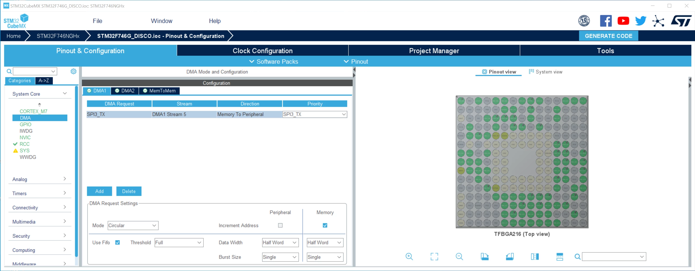

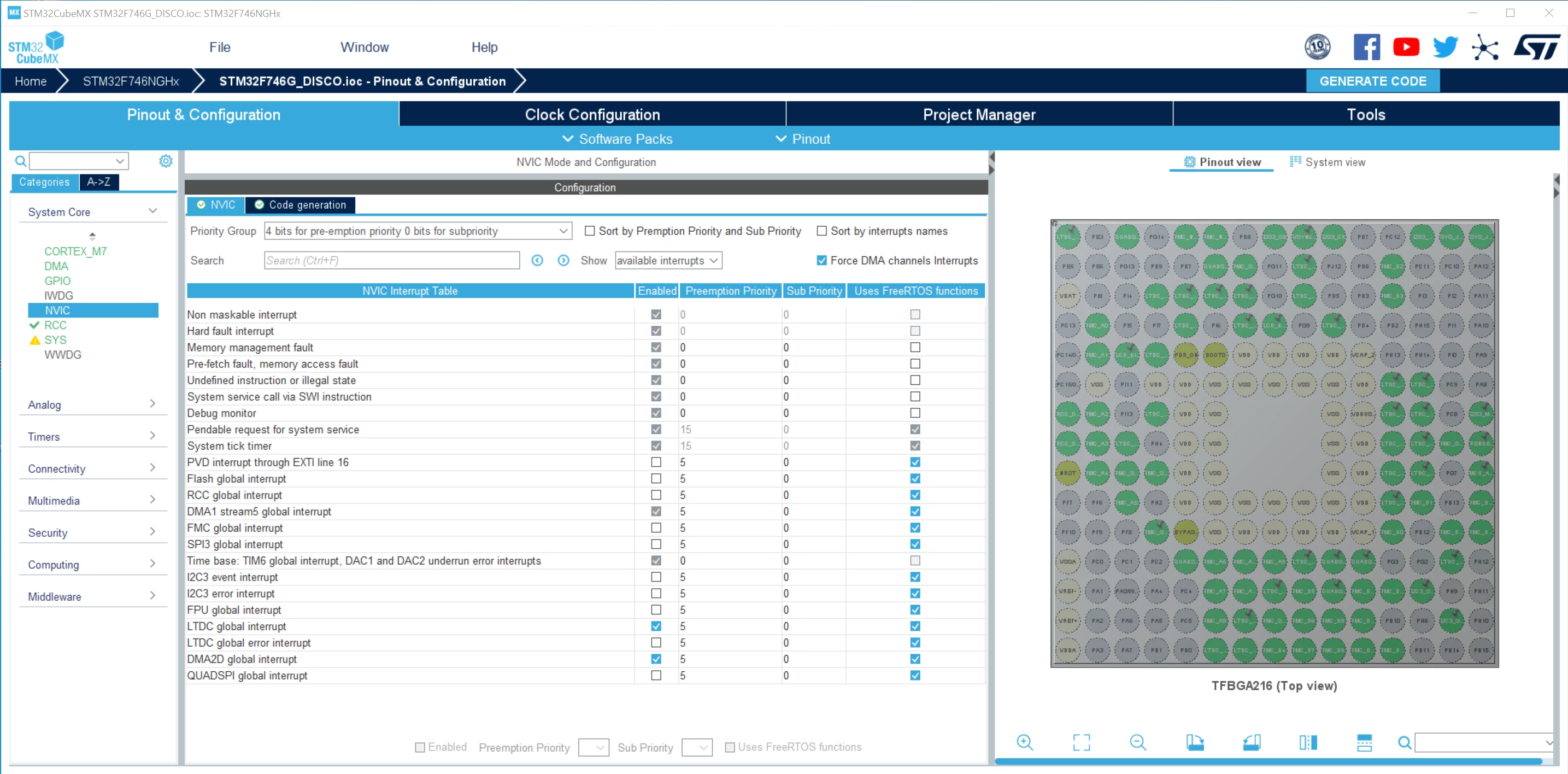

Does anyone have an idea? Is there any special configuration needed in CubeMX that I don't have? I've configured SAI and DMA based on some tutorial, and since I can produce audio output, I think that at least something must be correct there. But why is it then freezing, i.e. why does the BSP_AUDIO_OUT_play function never finish?

only guessed : the "right" priorities are critical ! so try ...in nvic and dma settings.

Many thanks for the answer! Unfortunately I don't really know what you mean by that. I attached two Screenshots from CubeMX for the "DMA" and "NVIC" sections.
_legacyfs_online_stmicro_images_0693W00000biamgQAA.pngI'm not even at the point where I want to play a real sound file yet. That is all complexity that I can add once the basics work. Right now, I generate the samples directly in code using a sine function. And that works, since I can already hear it.

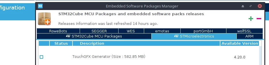

oh, i didnt know:
> it only runs in TouchGFX Designer and won't start in CubeIDE... pretty sad that those two tools are so incompatible
but you can select it in IDE -> software packs
_legacyfs_online_stmicro_images_0693W00000bifxAQAQ.pngand from https://www.st.com/en/development-tools/touchgfxdesigner.html ->
  • Tool-generated code entirely separated from user code
  • Support of several integrated development environments such as IAR Embedded Workbench, Arm Keil, and GCC-based IDEs
should work in IDE... read:
https://electronics.stackexchange.com/questions/570667/stm32cubeide-how-to-import-complete-working-program-from-touchgfx-designer
+ howto...
https://community.element14.com/technologies/embedded/b/blog/posts/stm32h7b3i---create-a-touchgfx-project-with-support-for-the-designer-cubeide-and-debugger---pt-1-screen-works
