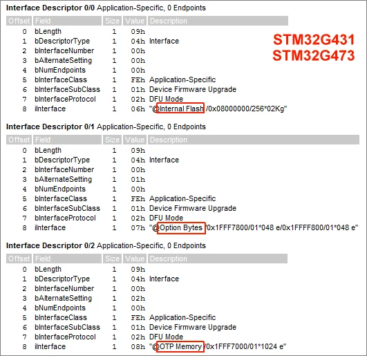

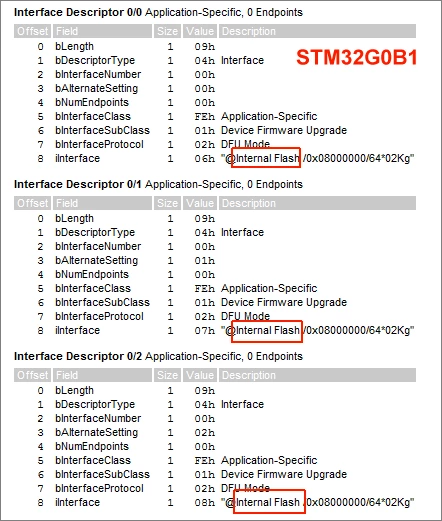

Bootloader over DFU expose duplicate internal Flash interface
Following the original discussion here, this topic is split into a separate issue to remain aligned with Community guidelines and better visibility.
DFU mode
This processor can program the Option Bytes over DFU
DFU Mode
This Processor is totally misdesigned
It exposes the Flash memory 3 times
For me this looks like a severe bug.
If you have a STM32G0B1 with read and write protection there is NO WAY over DFU get rid of these protections.
1 reply
Sep 17, 2026 10:58 AM UTC
Hi ​@Elmue
Thank you for highlighting the issue,
An internal ticket CDM0065832 is submitted to dedicated team to fix the interface descriptor for G0Bx products.
To give better visibility on the answered topics, please click on "Best answer" on the reply which solved your issue or answered your question.Best regards,FBL
