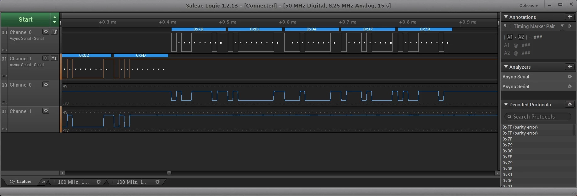

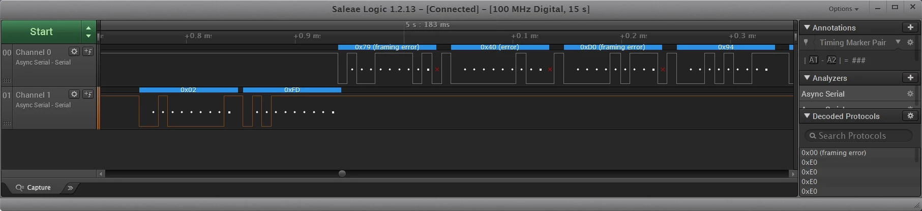

I'm writing an application on an STM32L052 that uses the UART (115200-N81), and I need to use the Bootloader for code upgrades.
If run the Bootloader using the BOOT0 pin, the UART initializes fine and I can upload code at any baud.   However if I jump to the Bootloader code from my application, the Bootloader isn't initializing the UART correctly, and I get framing-errors transmitted out from the CPU.
From the scope traces (good and bad are attached), I can see that at any baud rate (115200-E81 shown), the Tx signal is switched to '0' between each byte instead of staying high, this causes a framing error.   It almost seems as though the stop-bit is missing or inverted.
I'm guessing that in my application's use of the serial port, something is left in a register somewhere that doesn't get initialized in the Bootloader code.   Since I cannot modify the Bootloader code, I need to find the errant register that causes a missed stop-bit, or causes this framing error.

So, this issue has been fixed.   The first suggestion cleared things up.
Prior to jumping to the Bootloader, I had called HAL_UART_MspDeInit(&huart1); and all the other peripheral de-init functions, disabled and cleared all ints per AN2606.   However the de-init functions do not set the registers back to the bootup state.
With some further trials, i've narrowed it down to the USART1->CR1 register.   The DeInit function leaves the 'UE' bit enabled.   If you jump into the bootloader with the UART enabled, it does not initialize correctly.
And, I found that if you run the DeInit function, you cannot overwrite some of the USART1 registers to '0'.   Instead, I no longer call the DeInit function for the UART, but just zero out the bits with direct register writes.    It's working good now.
