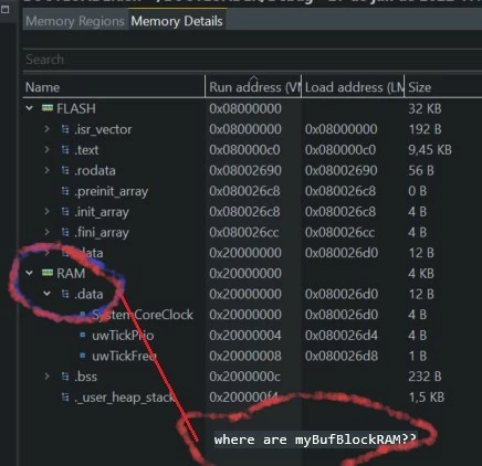

in the linker, i write:
.myBufBlockRAM 0x200100:
KEEP(*(myBufSectionkRAM)) /* MANTIENE MI VARIABLE SIEMPRE QUE NO ES REFERENCIADA */
}>RAM

Not sure why you need to allocate a buffer in that way, but surely needs to be 0x20000100 not 0x200100​

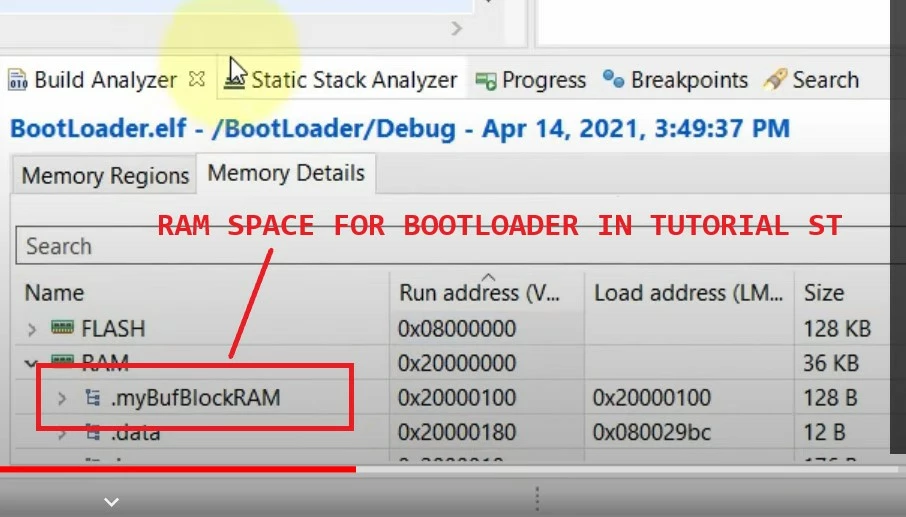

I AM DOING THIS TUTORIAL ST: (332) How to Create a Super Simple Bootloader, Part 1: Getting Started - YouTube,
What way do you recommend to make a simple bootloader?
how do I determine how many bytes there are from 0x2000 0000 to 0x20000100?
I'm sorry for my ignorance, I'm not an expert in stm32, some time ago I programmed in c with microchip, but I'm programming a board with stm32, and I like to discover.
Used, or physically?
0x100 -> 256 bytes
Still it says 0x20000100, not 0x200100. The basis of RAM in Cortex-Mx parts is 0x20000000, FLASH 0x08000000
He's allocating space for variables/structures you want in common between the two.
You could advance the basis of RAM in the linker script, and use a structure via a pointer.
Are you sharing a lot of information between the two? Usually apps are free standing, and the loader basically just needs to validate them, and provide a means/method of updating or disaster recovery.
The CM0 gets more involved as you can't relocate the Vector Table, other than remapping RAM, and in this case you want to carve out a section for the Vector Table at 0x20000000..0x2000007F to accomodate a copy of the table, and then remap/shadow this memory at the 0x00000000 address.
MEMORY
 VECTORRAM (xrw) : ORIGIN = 0x20000000, LENGTH = 128
 RAM (xrw) : ORIGIN = 0x20000080, LENGTH = 4K - 128
 FLASH (rx) : ORIGIN = 0x8000000, LENGTH = 32K

Jun 28, 2022 2:48 PM UTC
0693W00000NsyAQQAZ.jpgin the tutorial st youtube i view this
