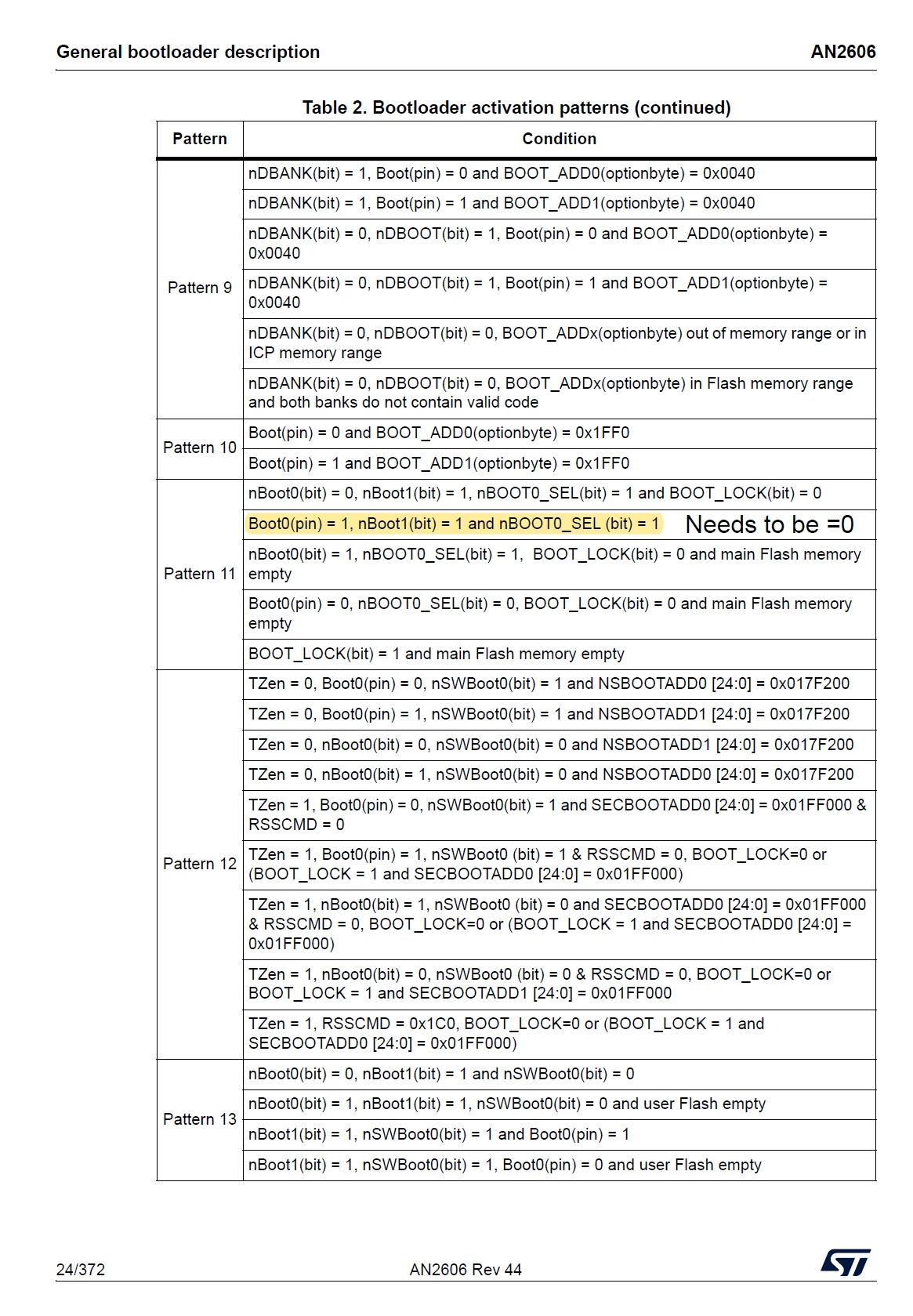

DMugiVisitor II6 years agoAugust 24, 2020QuestionBootloader Activation Pattern 11 for STM32G03xxx in AN2606 Revision 44 wrong1 reply787 viewsHi,The second activation pattern 11 for STM32G03xxx in Table 2 in the AN2606 Revision 44 seems to be wrong, the "nBOOT0_SEL (bit)" has to be set to 0 not 1, since =0 means that the Boot pin state is relevant, =1 means it is irrelevantDocumentationBootloaderSTM32G0 series
