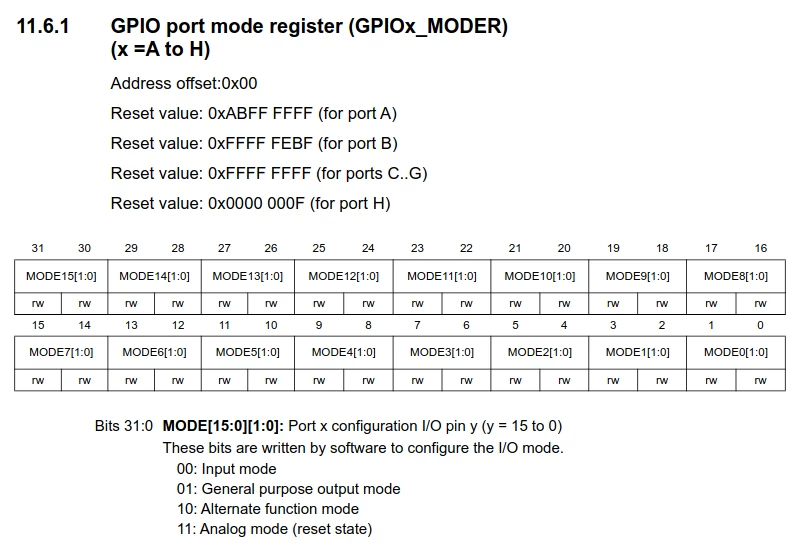

Hi @mƎALLEm ! I have now managed to get GDB up and running, and these are the contents of my registers:
  • The RCC register to enable AHB2 is at address 0x4002104c, and offset 0 has the GPIOA enable bit. The value as reported by GDB at that location is 0x00000001
  • I am also trying to designate PA9 as an output pin. GPIOA should be at address 0x42020000, and the mode register is at offset 0x00. The contents at address 0x42020000 is 0xabffffff
  • Finally, the output data register is at offset 0x14 from GPIOA (0x42020000). I set a watchpoint there, and I see that the value fluctuates between 0x00000200 and 0x00000000 with a second or two of delay. It seems as if this address changes value as I want it to, but it is just not actualised on the LED.
I am not sure what my take-away from this is. I wonder if the designation of PA9 as output is happening correctly. The documentation says that the reset value of port A is 0xabffffff. The operation on line 15 in my code is seemingly a no-op in that case?
Thanks for any further assistance you can render me.
Mike_ST
Mike_STBest answer
Sep 19, 2024 4:42 PM UTC
MODER9 reset value is not 0, please check the STM32L5 reference manual,
Perhaps you need to reset the 2 bits before setting the value to 1:
GPIOA->MODER &= ~(GPIO_MODER_MODE9_Msk);
GPIOA->MODER |= (1 << GPIO_MODER_MODE9_Pos);
