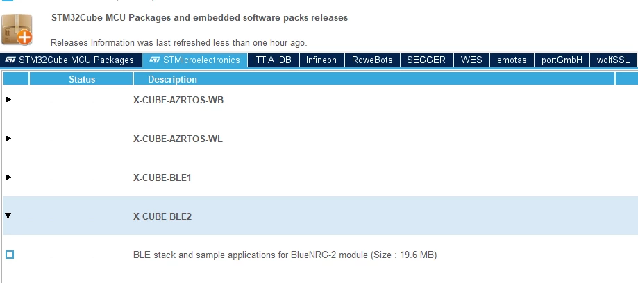

Hello @M_Sukumar,
You can generate your project using STM32CubeMX, choose B-L4S5I-IOT01A as a Board Selector and add the X-CUBE-BLE package from Help > Manage embedded Software packages > "STMicroelectronics".

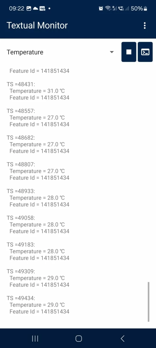

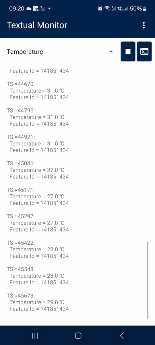

Jun 6, 2024 7:51 AM UTC
I have done the procedures as per the pdf ,but the sensor data in the app is not realtime and also some junk data it is producing in the mobile application
I have used mob application as st ble sensor.
Can you provide sufficient data to take sensor data logs into the mobile application.
Jun 10, 2024 4:53 AM UTC
Hi @M_Sukumar . Did you getting the real time data in the mentioned mobile application(st ble sensor)?,because after the configuring as per the pdf am able to connect ble to board, application am using in computer are stm32 ide and teraterm. But the data shown in mobile application is not as per teraterm (ie it's not real time).Can you reply on this and if you know please help on this problem.
Thanks
Visitor II
Jun 14, 2024 6:33 AM UTC
See the attached snapshots.
Jun 14, 2024 6:46 AM UTC
For me the data was random because of
Set_Random_Motion_Values() inside
User_Process() function ,so i have taken these application specified functions into main.c file and tried and got the exact realtime values . can you check the data you shown in screenshot is changing while you made any temp change on the temp sensor?, please reply if this is not the way.
