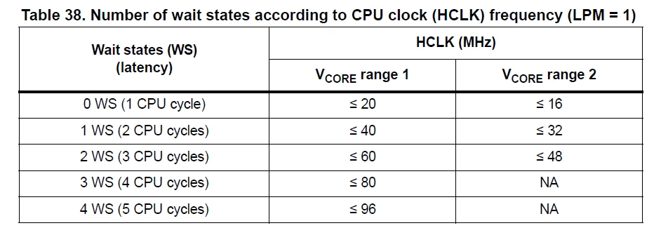

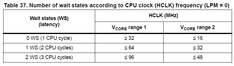

Illustrations:
  • When Flash low-power read mode LPM = disabled:
  • When Flash low-power read mode LPM = enabled:

  4. Additional Best Practices:
Illustrations:
