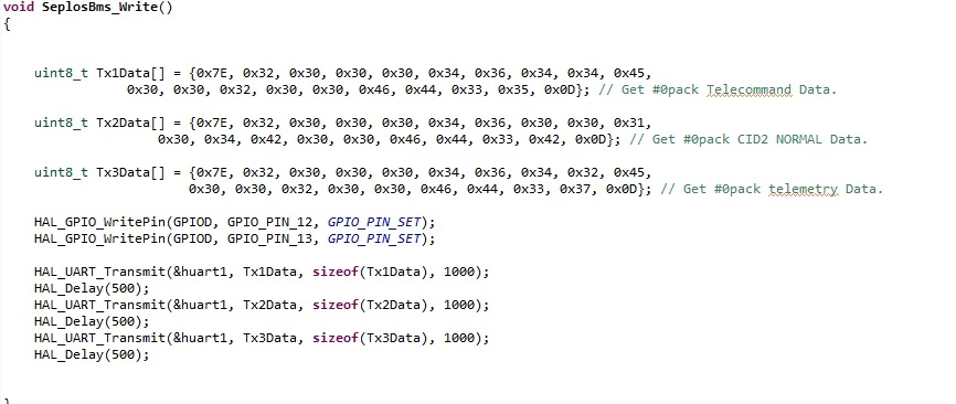

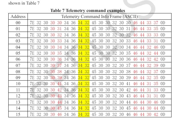

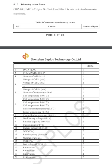

battery management system not communicating via RS485 with STM32
I have a SEPLOS brand battery management system card, and I want to read temperature and voltage data from this card. Initially, I will use an STM32F407VGT6 board to read data from the SEPLOS battery management system card via RS485. I am sending the commands first to get the data, but although the data is being sent, I cannot perform the reading operation. What do you think could be the reason for this problem?
The PDF I will send below contains an information sheet about how I should read data from the SEPLOS brand battery management system via RS485. Please look at the PDF and my code to see if you can find where I might be making a mistake.

Please use the </> icon to paste in code, not attach as bitmaps, thanks.
I'd perhaps be concerned about how you have it wired to the STM32, the pins, the RS485 driver, and how you gate that as an output.
Use a scope or logic analyzer to review the signals you generated on the wires, and the responses, if any, from the BMS

I checked my connections and there are no issues. I am sending you the code again.

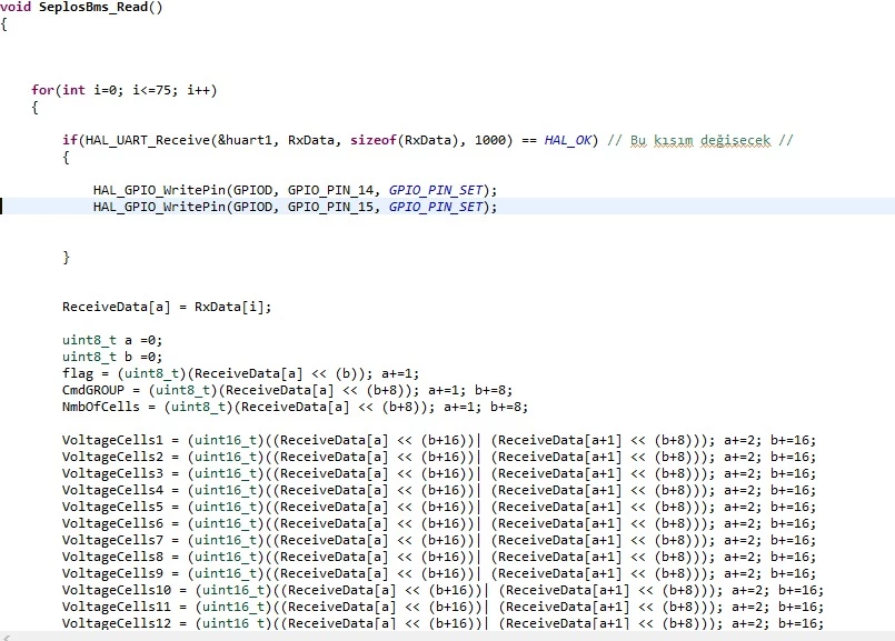

How is your main loop()? Can you post the code using <> method? After sending read request do you do the read ?

Have you tried using a SEPLOS USB adapter with a terminal program on a PC to determine that the SEPLOS is functioning correctly ?
sezear07Author
Jun 21, 2024 3:52 PM UTC
Yes, SEPLOS has its own programs, and with these programs, I can read temperature and voltage data.

Connect another 485 to USB adapter on the network to a terminal program, run the SEPLOS program, then your configuration and compare to see where the disconnect is. The terminal program won't provide timing, but will show the command and response sequence. The terminal will probably have to be in HEX mode.

Can you post your full code?

void SeplosBms_Write()
	uint8_t Tx1Data[] = {0x7E, 0x32, 0x30, 0x30, 0x30, 0x34, 0x36, 0x34, 0x34, 0x45,
				0x30, 0x30, 0x32, 0x30, 0x30, 0x46, 0x44, 0x33, 0x35, 0x0D}; // Get #0pack Telecommand Data.
	uint8_t Tx2Data[] = {0x7E, 0x32, 0x30, 0x30, 0x30, 0x34, 0x36, 0x30, 0x30, 0x31,
					0x30, 0x34, 0x42, 0x30, 0x30, 0x46, 0x44, 0x33, 0x42, 0x0D}; // Get #0pack CID2 NORMAL Data.
	uint8_t Tx3Data[] = {0x7E, 0x32, 0x30, 0x30, 0x30, 0x34, 0x36, 0x34, 0x32, 0x45,
						0x30, 0x30, 0x32, 0x30, 0x30, 0x46, 0x44, 0x33, 0x37, 0x0D}; // Get #0pack telemetry Data.
	HAL_GPIO_WritePin(GPIOD, GPIO_PIN_12, GPIO_PIN_SET);
	HAL_GPIO_WritePin(GPIOD, GPIO_PIN_13, GPIO_PIN_SET);
	HAL_UART_Transmit(&huart1, Tx1Data, sizeof(Tx1Data), 1000);
	HAL_Delay(500);
	HAL_UART_Transmit(&huart1, Tx2Data, sizeof(Tx2Data), 1000);
	HAL_Delay(500);
	HAL_UART_Transmit(&huart1, Tx3Data, sizeof(Tx3Data), 1000);
	HAL_Delay(500);
void SeplosBms_Read()
	for(int i=0; i<=75; i++)
		if(HAL_UART_Receive(&huart1, RxData, sizeof(RxData), 1000) == HAL_OK) // Bu kısım değişecek //
			HAL_GPIO_WritePin(GPIOD, GPIO_PIN_14, GPIO_PIN_SET);
			HAL_GPIO_WritePin(GPIOD, GPIO_PIN_15, GPIO_PIN_SET);
		ReceiveData[a] = RxData[i];
		uint8_t a =0;
		uint8_t b =0;
		flag = (uint8_t)(ReceiveData[a] << (b)); a+=1;
		CmdGROUP = (uint8_t)(ReceiveData[a] << (b+8)); a+=1; b+=8;
		NmbOfCells = (uint8_t)(ReceiveData[a] << (b+8)); a+=1; b+=8;
	 VoltageCells1 = (uint16_t)((ReceiveData[a] << (b+16))| (ReceiveData[a+1] << (b+8))); a+=2; b+=16;
		VoltageCells2 = (uint16_t)((ReceiveData[a] << (b+16))| (ReceiveData[a+1] << (b+8))); a+=2; b+=16;
		VoltageCells3 = (uint16_t)((ReceiveData[a] << (b+16))| (ReceiveData[a+1] << (b+8))); a+=2; b+=16;
		VoltageCells4 = (uint16_t)((ReceiveData[a] << (b+16))| (ReceiveData[a+1] << (b+8))); a+=2; b+=16;
		VoltageCells5 = (uint16_t)((ReceiveData[a] << (b+16))| (ReceiveData[a+1] << (b+8))); a+=2; b+=16;
		VoltageCells6 = (uint16_t)((ReceiveData[a] << (b+16))| (ReceiveData[a+1] << (b+8))); a+=2; b+=16;
		VoltageCells7 = (uint16_t)((ReceiveData[a] << (b+16))| (ReceiveData[a+1] << (b+8))); a+=2; b+=16;
		VoltageCells8 = (uint16_t)((ReceiveData[a] << (b+16))| (ReceiveData[a+1] << (b+8))); a+=2; b+=16;
		VoltageCells9 = (uint16_t)((ReceiveData[a] << (b+16))| (ReceiveData[a+1] << (b+8))); a+=2; b+=16;
		VoltageCells10 = (uint16_t)((ReceiveData[a] << (b+16))| (ReceiveData[a+1] << (b+8))); a+=2; b+=16;

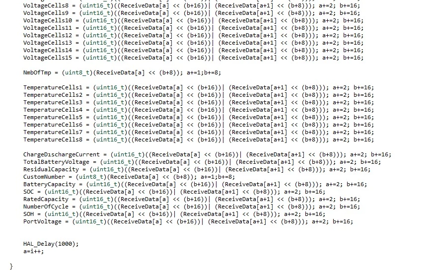

		VoltageCells11 = (uint16_t)((ReceiveData[a] << (b+16))| (ReceiveData[a+1] << (b+8))); a+=2; b+=16;
		VoltageCells12 = (uint16_t)((ReceiveData[a] << (b+16))| (ReceiveData[a+1] << (b+8))); a+=2; b+=16;
		VoltageCells13 = (uint16_t)((ReceiveData[a] << (b+16))| (ReceiveData[a+1] << (b+8))); a+=2; b+=16;
		VoltageCells14 = (uint16_t)((ReceiveData[a] << (b+16))| (ReceiveData[a+1] << (b+8))); a+=2; b+=16;
		VoltageCells15 = (uint16_t)((ReceiveData[a] << (b+16))| (ReceiveData[a+1] << (b+8))); a+=2; b+=16;
		NmbOfTmp = (uint8_t)(ReceiveData[a] << (b+8)); a+=1;b+=8;
		TemperatureCells1 = (uint16_t)((ReceiveData[a] << (b+16))| (ReceiveData[a+1] << (b+8))); a+=2; b+=16;
		TemperatureCells2 = (uint16_t)((ReceiveData[a] << (b+16))| (ReceiveData[a+1] << (b+8))); a+=2; b+=16;
		TemperatureCells3 = (uint16_t)((ReceiveData[a] << (b+16))| (ReceiveData[a+1] << (b+8))); a+=2; b+=16;
		TemperatureCells4 = (uint16_t)((ReceiveData[a] << (b+16))| (ReceiveData[a+1] << (b+8))); a+=2; b+=16;
		TemperatureCells5 = (uint16_t)((ReceiveData[a] << (b+16))| (ReceiveData[a+1] << (b+8))); a+=2; b+=16;
		TemperatureCells6 = (uint16_t)((ReceiveData[a] << (b+16))| (ReceiveData[a+1] << (b+8))); a+=2; b+=16;
		TemperatureCells7 = (uint16_t)((ReceiveData[a] << (b+16))| (ReceiveData[a+1] << (b+8))); a+=2; b+=16;
		TemperatureCells8 = (uint16_t)((ReceiveData[a] << (b+16))| (ReceiveData[a+1] << (b+8))); a+=2; b+=16;
		ChargeDıschargeCurrent = (uint16_t)((ReceiveData[a] << (b+16))| (ReceiveData[a+1] << (b+8))); a+=2; b+=16;
		TotalBatteryVoltage = (uint16_t)((ReceiveData[a] << (b+16))| (ReceiveData[a+1] << (b+8))); a+=2; b+=16;
		ResidualCapacity = (uint16_t)((ReceiveData[a] << (b+16))| (ReceiveData[a+1] << (b+8))); a+=2; b+=16;
		CustomNumber = (uint8_t)(ReceiveData[a] << (b+8)); a+=1;b+=8;
		BatteryCapacity = (uint16_t)((ReceiveData[a] << (b+16))| (ReceiveData[a+1] << (b+8))); a+=2; b+=16;
		SOC = (uint16_t)((ReceiveData[a] << (b+16))| (ReceiveData[a+1] << (b+8))); a+=2; b+=16;
		RatedCapacity = (uint16_t)((ReceiveData[a] << (b+16))| (ReceiveData[a+1] << (b+8))); a+=2; b+=16;
		NumberOfCycle = (uint16_t)((ReceiveData[a] << (b+16))| (ReceiveData[a+1] << (b+8))); a+=2; b+=16;
		SOH = (uint16_t)((ReceiveData[a] << (b+16))| (ReceiveData[a+1] << (b+8))); a+=2; b+=16;
		PortVoltage = (uint16_t)((ReceiveData[a] << (b+16))| (ReceiveData[a+1] << (b+8))); a+=2; b+=16;
		HAL_Delay(1000);
		a=i++;
Tesla DeLorean
Guru
Jun 21, 2024 5:08 PM UTC
Data isn't buffered by the UART.
Errors generated whilst not listening need to be cleared.
Presumably RS485 is used half-duplex, not indication of hardware or software affecting that implementation.
Loop implies 76 * 76 bytes (5776) received
Perhaps you wanted to receiver 76 bytes, move them to a secondary buffer, and then process / separate them there?

What I want to do is send telemetry data from the datasheet with the STM32F407VGT6 board and then read the 75-byte long temperature and voltage data. I have no issues with the data transmission process; it is successful. However, I am unable to read the data during the receiving process. Are you suggesting that using DMA to read the necessary data when the line is idle?
Senior III
Jun 22, 2024 5:35 AM UTC
It is not mandatory to use DMA, you can use any mode to read the data. Basically read means send a command to
CORRECT address as se the DIP switch. Make sure that you send the command bytes correctly, Check sum and Length etc. While sending keep DE/RE to  1 so that transmission happens and immediately switch over to 0 for the unit to respond. Receive till 0x0D
eg of query command from the datasheet
if you prefer to read in your main loop keep reading till you get 0x0D or in interrupt you can receive one byte  each till you assemble all bytes till 0x0D. Then inform main loop to process the data. The response will happen if you send it to the correct address, else nil. At least one message you hand code carefully and test it.
Timeout of 500ms can be implemented to avoid infinite waiting.

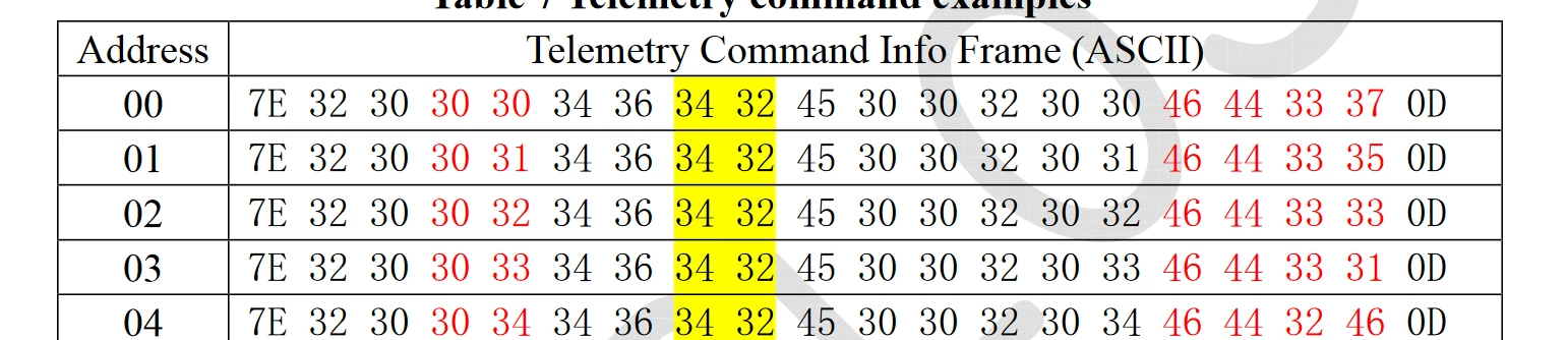

Do you know how to manually set the address? For example, I manually keep the address positions at zero and send the command based on the address value 00.
As far as I understand, the STM sends commands based on the data in Table 7. For example, after sending the telemetry data at address 00 in Table 7, we should automatically receive the parameters such as cell voltages and cell temperatures listed in Table 8, right? My main question is, if I need to store the temperature and voltage parameters from Table 8 into specific arrays, those bits should correspond to the temperature and voltage values we need. However, it is not specified in Table 8 which bytes the temperature and voltage data should be stored in. In this case, do you think my void SeplosBms_Read(); function is written correctly? Do you see any other errors in the code?
Senior III
Jun 22, 2024 11:54 AM UTC
How many devices are there? you need to know the address. earlier you made a statement that transmit is success, does it mean that when you send data, any parameter gets changed in the target device?
make sure that you connect A ->A and B->B  and GND
I am not familiar with your system. There must be some way to set the address by some dip switches. You need to know the set address.
you need to go step by step. Your first problem was how to get some response from the target device. Once you receive that you can start interpreting the data based on table 8,9 .
Let us know once you are able to get response from the target device.
Table 8 seems clear in the sense that the how many bytes are needed for each parameters, you need to count it as per the table, first read the number of cells and based on that you can count from the start of the frame. Looks like if you read the document multiple times and  analyze you can do it.
