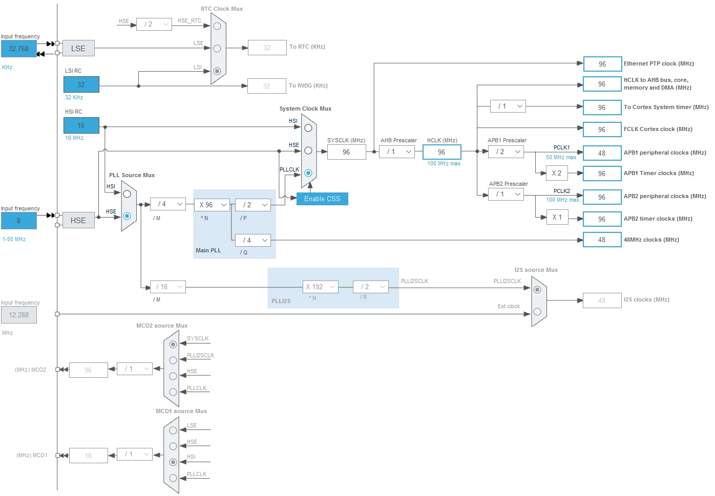

The following is set in CubeMX:
Connectivity:
- USB_OTG_FS / Device_Only
- "Activate_SOF" and "Activate_VBUS" are inactive.
- Middleware: USB_Device / Communication Device Class (Virtual Port Com)

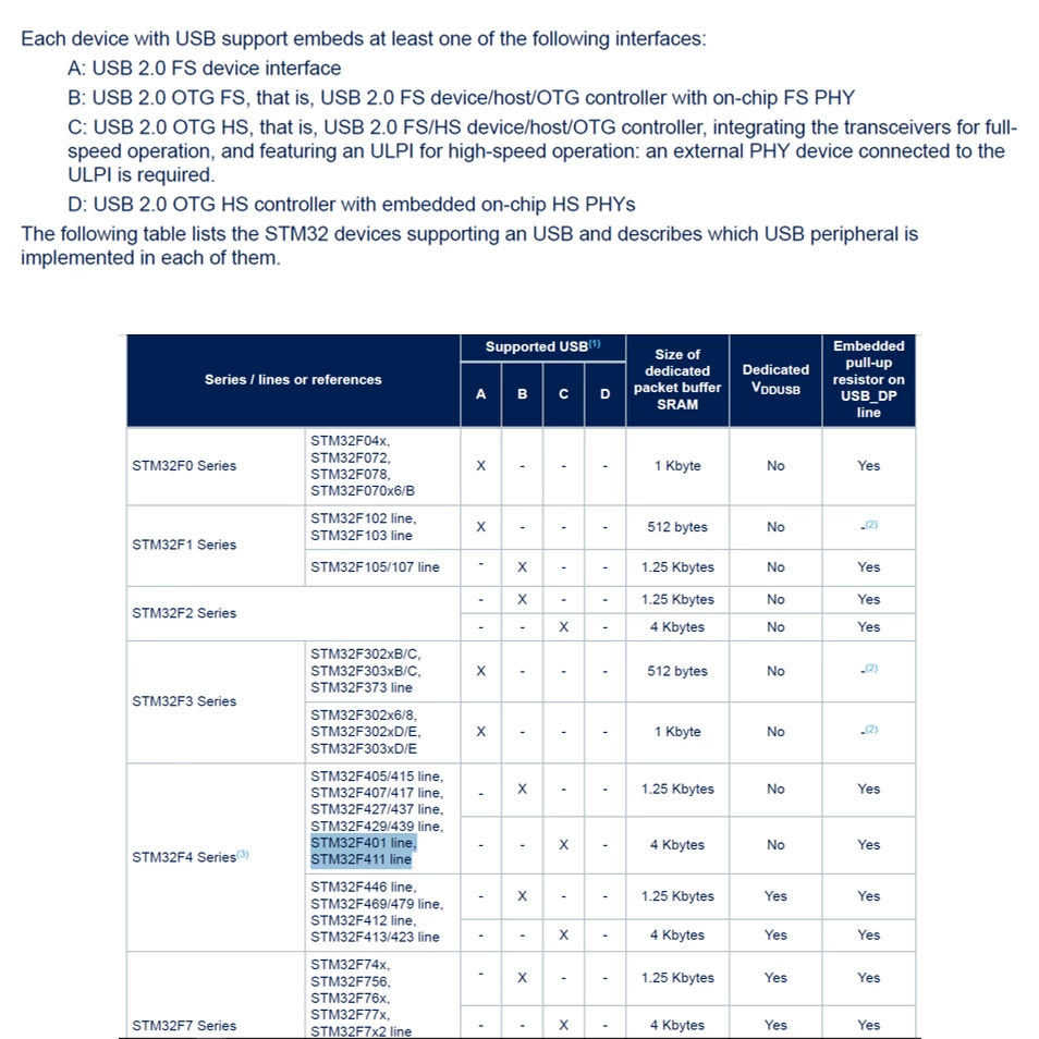

In the AN4879 Page 3 it is noted that the F4X1 has the interface "C" and the L4X6 chip has the interface "B". This is the only difference I could discover. With the L4X6 chip it had worked (interface "B"). What is different between "B" and "C" in FS mode?
B: USB 2.0 OTG FS, that is, USB 2.0 FS device/host/OTG controller with on-chip FS PHY
C: USB 2.0 OTG HS, that is, USB 2.0 FS/HS device/host/OTG controller, integrating the transceivers for fullspeed
operation, and featuring an ULPI for high-speed operation: an external PHY device connected to the
ULPI is required.
