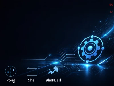

Hi everyone,
I wanted to share a project I’ve been building over the last few years. It’s called Mk, an operating system built entirely from scratch for the STM32F746G-DISCO and STM32F746G-Eval2 boards.
These boards are powered by an ARM Cortex-M7 running at 216MHz. Initially, my goal was just to implement a small scheduler, but I stacked layers one after another to make it as complete as possible. Currently, I think I've added enough layers to claim it as a functional, lightweight OS.
Mk features:
A Kernel
  • Preemptive, priority-based multitasking scheduler (fixed-priority, O(1) selection via hardware CLZ instruction)
  • Trusted Execution Environment (TEE) using the Cortex-M7 MPU (privileged and unprivileged mode isolation)
  • Synchronization primitives: mutex, semaphore, event flags, mailbox
  • Fixed-size memory pools
  • Synchronous and asynchronous callback execution system
A Dynamic ELF Loader Mk can load and execute external .elf binaries at runtime, relocated dynamically into 64 KB pages of the external SDRAM. Programs reference Mk's own API symbols directly via extern . The full kernel symbol table is embedded in the firmware at a fixed address meaning external applications require no copy of the kernel API in their own binary. See the sym2srec tool for details on the symbol embedding mechanism.

A Graphics Engine
  • Hardware-accelerated 2D rendering pipeline using the LTDC and ChromART (DMA2D) accelerators
  • Drawing primitives (rectangles, circles, lines, arcs), BMP 24/32-bit image rendering
  • Full Unicode text rendering (UTF-8/16/32)
  • UI widget library: buttons, text fields, edit fields, graphs, cursors, layers
A Shell Built-in interactive shell with support for both native and dynamically loaded commands.

Application prototype: A minimal application example can be found here (a simple BlinkLed). It must be paired with a linker script, an application descriptor (mk_application_data) and compiled with the following flags: -fPIC -shared. Symbol resolution at runtime is handled in mk_application_loadDynamic() and in this sources directory. Other example applications can be found here: a Pong game and the built-in Shell.
Graphics Engine: The graphics engine is composed of several tasks that execute painting callbacks, input-listening callbacks, and process drawing requests submitted by applications. Each module is isolated and interactions between components go through asynchronous requests. The rendering pipeline entry point is mk_display_painter(), the listening entry point is mk_display_listener() and the request manager entry point is mk_display_handler().
