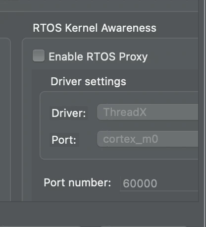

Have you enabled the "RTOS Kernel Awareness" in the debug configuration (presuming you are using CubeIDE)? This can help when stepping through tasks.These settings are on the "Debugger" Tab in the "Debug Configurations" dialog. See the CubeIDE users manual for details.
jmazz.1
jmazz.1Author
May 25, 2023 12:33 AM UTC
_legacyfs_online_stmicro_images_0693W00000bknzSQAQ.pngI see these settings. What values do I enter?
