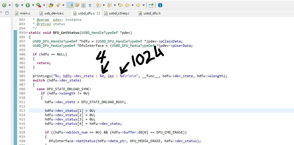

I have further debugged this.
I have found that tool sends request for get status to device.
At that time USBD is in configured state. And DFU state is busy(4 as shown in screen shot).
Anyone has idea for this ? I have been stuck for this since long. Any help would be great.

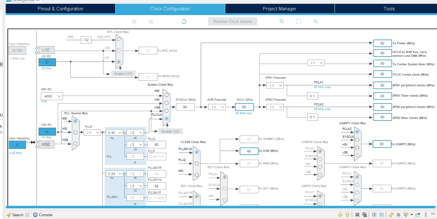

Jun 16, 2022 11:02 AM UTC
Hi @Keyur Thumar​ ,
Maybe the problem here is caused by the HSE crystal. I recommend you these FAQs that may help you on your issue:
  1. How to Modify USB DFU firmware examples to work with STM32CubeProgrammer
Hope my answer helps you!
Imen
Keyur Thumar
Jun 17, 2022 1:29 PM UTC
Thanks @Imen DAHMEN​  I am not using HSE.
