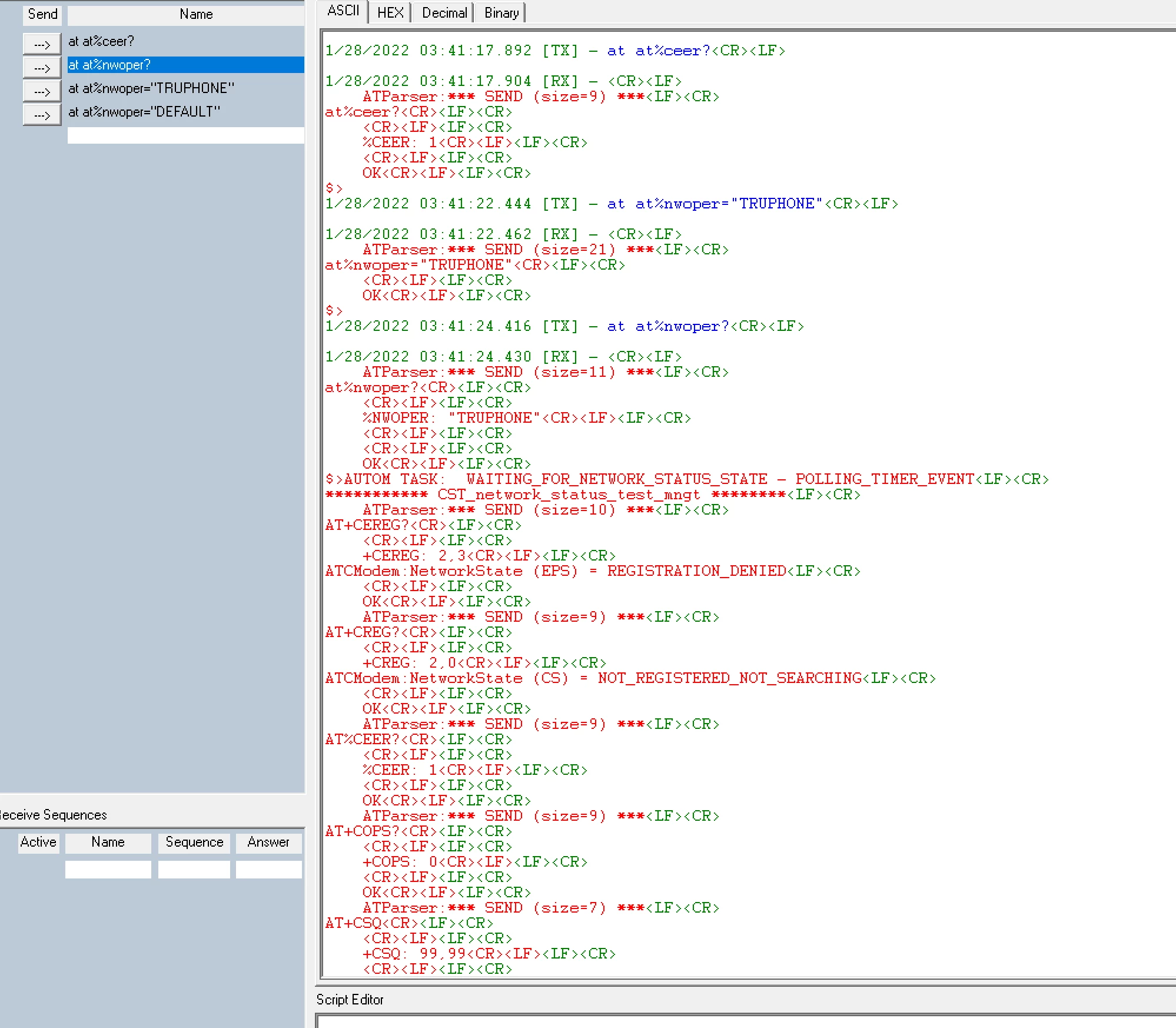

Aeh1
Jan 27, 2022 8:46 PM UTC
Hi, I', In Thailand and also in Truphone list
I also got
ATCModem:NetworkState (EPS) = REGISTRATION_DENIED<LF><CR>
Firmware out of the box haven't been updated yet.
Anyone can tell me how to set APN for 2 sim (eSim and external plastic sim)?
If I cannot make Truphone work, I will try external sim card, I have TRUE(Operator in Thailand) NB-IoT and LTE-M1 sim card.
How to get below information? I used Keil not STM32IDE
Sim Slot 0: 0 (MODEM SOCKET)
APN: iot.truphone.com
CID: 1
username:
password:
Sim Slot 1: 1 (MODEM EMBEDDED SIM)
CID: 2
username:
password:
modem target_state: 2
attachment timeout: 180000 ms
Network register mode: 0 = Auto
Operator name format: 9 = Not present
Operator name: 00101
Access techno present: Not present
Network register mode: 7 = CatM1
Low power inactivity timeout: 1000 ms
NFMC activation : 0
I DO NOT GET any answer from ceer?
at at%ceer?<CR><LF>
1/28/2022 03:36:43.080 [RX] - <CR><LF>
  ATParser:*** SEND (size=9) ***<LF><CR>
at%ceer?<CR><LF><CR>
  <CR><LF><LF><CR>
  %CEER: 1<CR><LF><LF><CR>
  <CR><LF><LF><CR>
  OK<CR><LF><LF><CR>
Also change from "DEFAULT" to "TRUPHONE"
1/28/2022 03:39:00.586 [TX] - at at%nwoper="TRUPHONE"<CR><LF>
1/28/2022 03:39:00.589 [RX] - <CR><LF>
  ATParser:*** SEND (size=21) ***<LF><CR>
at%nwoper="TRUPHONE"<CR><LF><CR>
  <CR><LF><LF><CR>
  OK<CR><LF><LF><CR>
I tested in my house, rssi 99, is it good or bad?
-Sig quality rssi : 99<LF><CR>
 -Sig quality ber : 99<LF><CR>
0693W00000JNbziQAD.pngPlease help? I guest many people face this problem as well.
Anyone has AT command to share? Or any guide line document for setting APN?

Aeh1
Jan 27, 2022 9:29 PM UTC
I read in forum and send at at%getacfg=radiom.config.preferred_rat_listI
It return none,
1/28/2022 03:50:47.793 [TX] - at at%getacfg=radiom.config.preferred_rat_list<CR><LF>
1/28/2022 03:50:47.798 [RX] - <CR><LF>
  ATParser:*** SEND (size=44) ***<LF><CR>
at%getacfg=radiom.config.preferred_rat_list<CR><LF><CR>
  <CR><LF><LF><CR>
  none<CR><LF><LF><CR>
  OK<CR><LF><LF><CR>
so I changed to NBIOT
1/28/2022 03:50:54.074 [TX] - at at%setacfg=radiom.config.preferred_rat_list,"NBIOT"<CR><LF>
1/28/2022 03:50:54.080 [RX] - <CR><LF>
  ATParser:*** SEND (size=52) ***<LF><CR>
at%setacfg=radiom.config.preferred_rat_list,"NBIOT"<CR><LF><CR>
  <CR><LF><LF><CR>
  OK<CR><LF><LF><CR>
Now CEER? return
EMM","ATTACH","REJECT",#14,EPS_SERVICES_NOT_ALLOWED_IN_THIS_PLMN<CR><LF>
ATCModem:NetworkState (CS) = REGISTRATION_DENIED<LF><CR>
  <CR><LF><LF><CR>
  OK<CR><LF><LF><CR>
AT%CEER?<CR><LF><CR>
  <CR><LF><LF><CR>
  %CEER: 1,"NAS-EMM","ATTACH","REJECT",#14,EPS_SERVICES_NOT_ALLOWED_IN_THIS_PLMN<CR><LF><LF><CR>
  <CR><LF><LF><CR>
  OK<CR><LF><LF><CR>
so I changed to CatM
1/28/2022 04:15:14.670 [TX] - at at%setacfg=radiom.config.preferred_rat_list,"CatM"<CR><LF>
1/28/2022 04:15:14.676 [RX] - <CR><LF>
  ATParser:*** SEND (size=51) ***<LF><CR>
at%setacfg=radiom.config.preferred_rat_list,"CatM"<CR><LF><CR>
  <CR><LF><LF><CR>
  OK<CR><LF><LF><CR>
Now CEER? return
  <CR><LF><LF><CR>
  OK<CR><LF><LF><CR>
  <CR><LF><LF><CR>
  <CR><LF><LF><CR>
  OK<CR><LF><LF><CR>
So is it work in Thailand?
I need to test with external plastic sim from Thai operator, do you have step by step setting guide?
It's not ok for this difficulty and unclear documents.
I almost give up and change solution to MCU + Simcom or Quectel modems that I can control every step.
