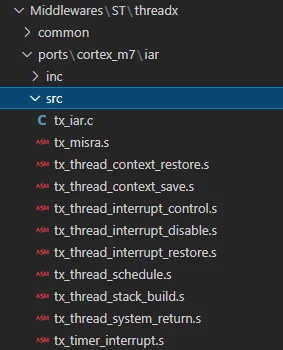

I'm trying to generate a project using the AzureRTOS software expansion package. When generating code through STM32CubeIDE the correct files are generated (I'm using a GNU ARM compiler), however when I set the Makefile option in CubeMX some files are generated for the IAR system instead of GNU. This causes compilation error. Is there a setting to make sure that the GNU files are generated instead of IAR?

You are right and I confirm the issue, it seems that the IAR folder is generated instead of the GNU folder when a Makefile project is generated.
I've raised this issue internally to be fixed as soon as possible. I'll keep you posted with the updates.

This issue still persists in 6.5.0 version.
Could you please fix it?

Hello @Hermund Døssland​, @NRedd.2​,
This issue is fixed in STM32CubeMX latest release.
V6.7.0 is now available under this Link.
