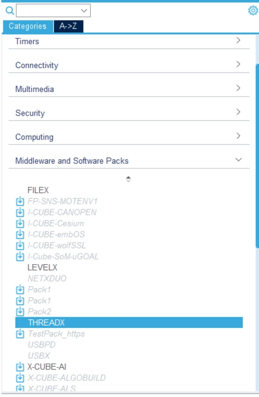

Hi @ElecDesigner​ , AzureRTOS is natively integrated in CubeMx For STM32 new product (U5/H5/WBA /C0 ...). , you can fin auzure rtos components under middleware and software packs

Check this link on github, there are a set of apps using Azure RTOS for STM32H563-NUCLEO board.
