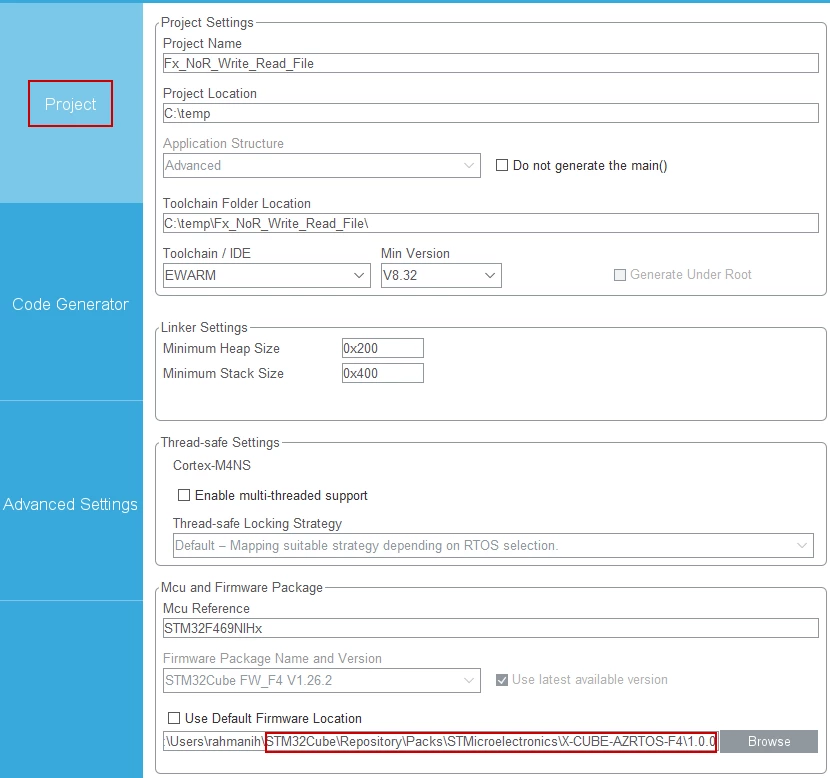

Haithem Rahmani
Jan 20, 2022 9:59 AM UTC
Hi @JAgen.1​,
under the STM32CubeMX "Project Manager" panel select the "Project" Tab and edit the Firmware location as shown below:
regards
Haithem.

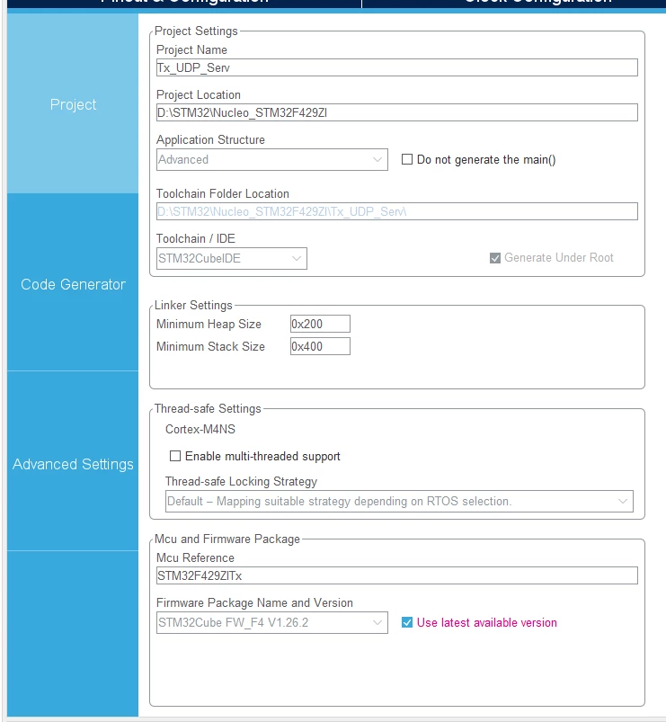

JAgen.1
Visitor II
Jan 23, 2022 9:37 PM UTC
Hi Haithem Rahmani,
thank you for your help ! unfortunately i do not get the line you mention (Firmware location) .
0693W00000JN0qTQAT.pngRegards,
Jacques
