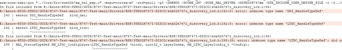

@CIsel.1 I have had no success rebuilding your project.
Sep 27, 2023 7:57 PM UTC
Any specific error message you could share ?
SLimi.1
Sep 27, 2023 8:35 PM UTC
something with the stm32h747i_discovery_lcd.h file. I am not going to worry about this too much.
