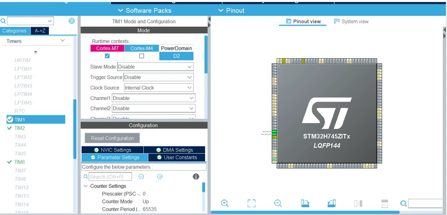

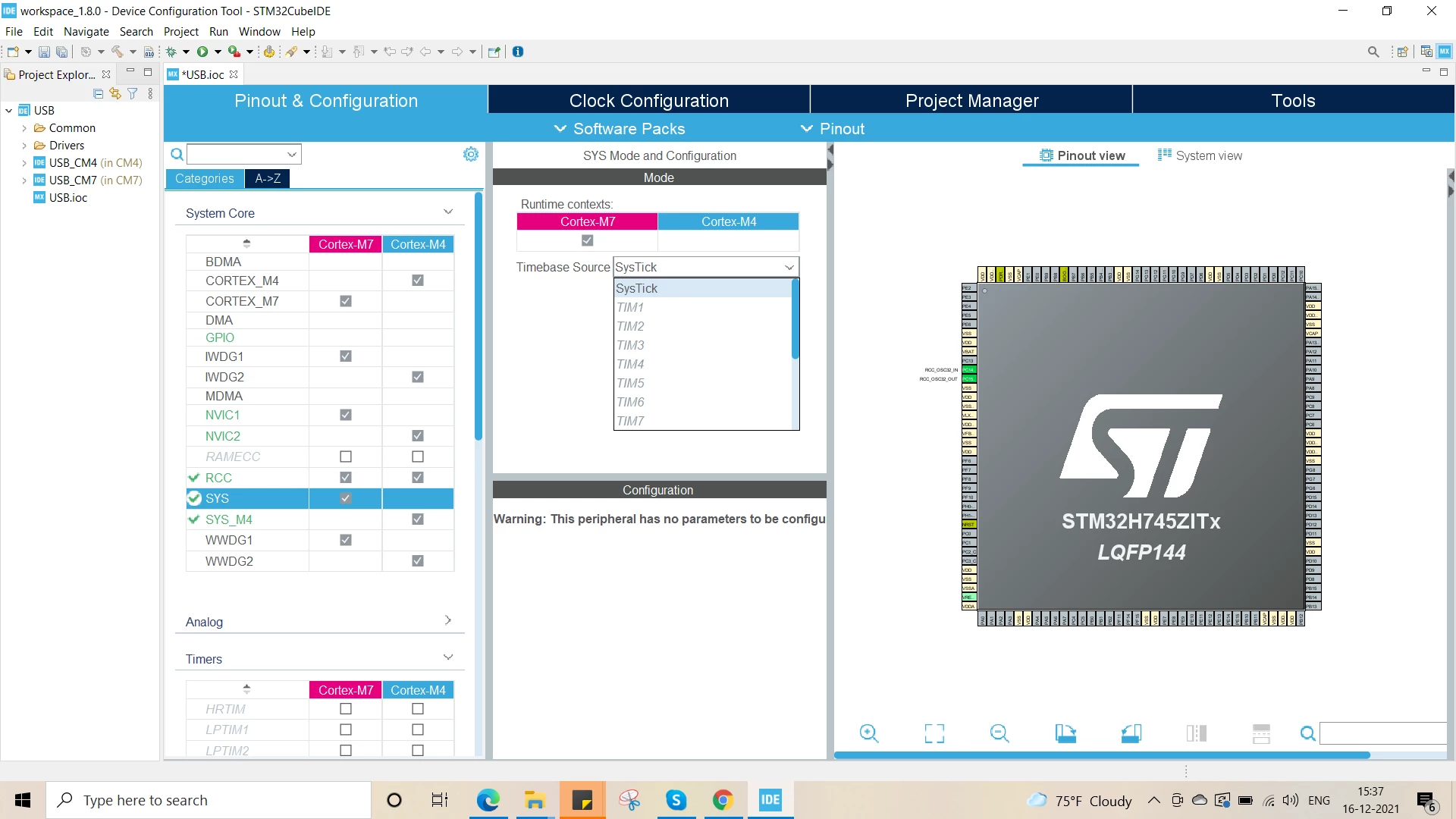

Hi @MDeva.1​
you'll need to assign the TIMER to the respective Core first.
0693W00000HocHXQAZ.pngthen the TIMER will be available for selection.
0693W00000HocIBQAZ.pngPS: the screen shot are from STM32CubeMX 6.4.0

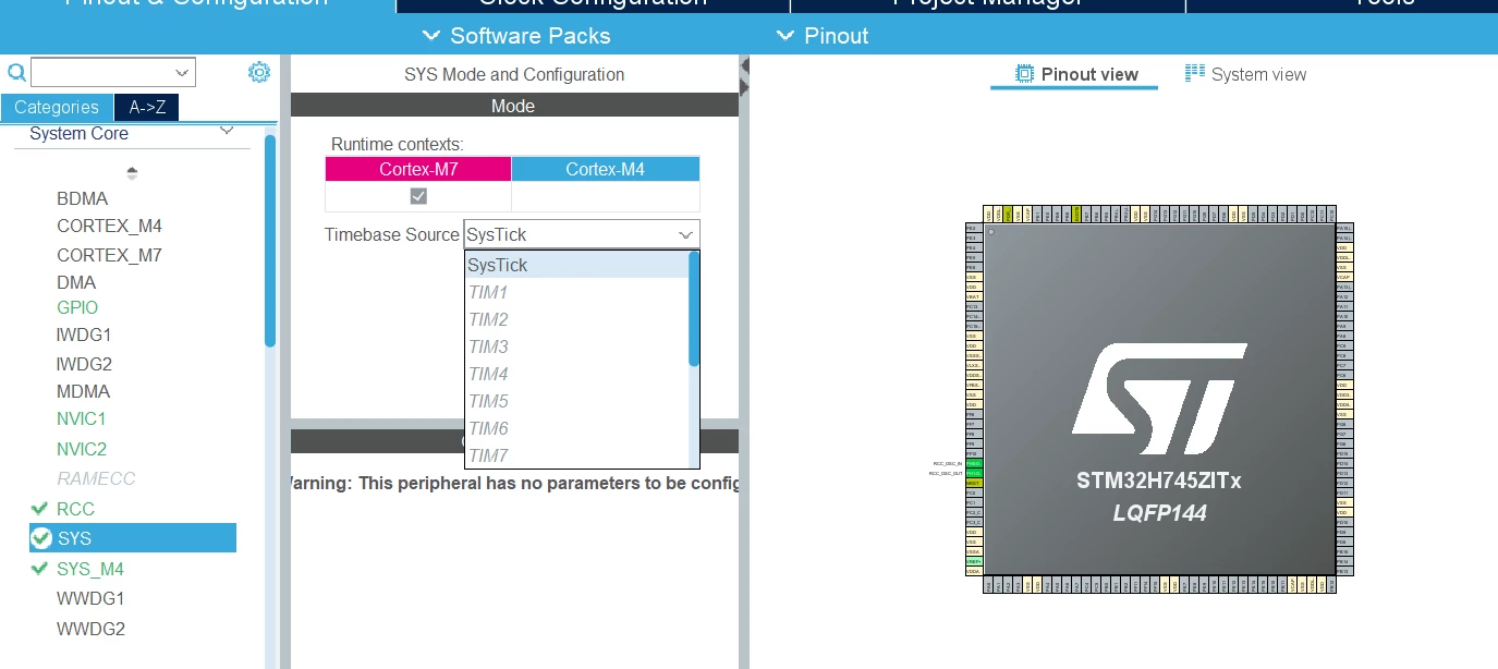

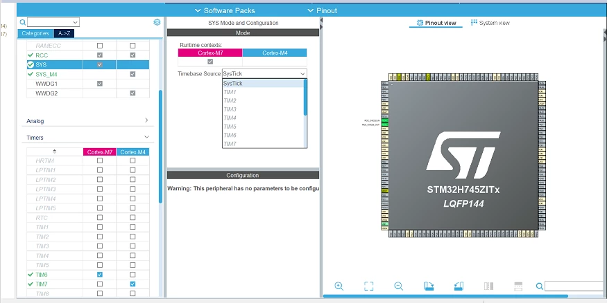

I am working on NUCLEO-H745ZIQ board. I am using the STM32CUBE IDE 1.7.0. According to you first I setup the TIMER to particular core ,after I tried to set to Timebase source but it doesnot allow me.I am sharing the snap shot.0693W00000Hoj3nQAB.png0693W00000Hoj4uQAB.png

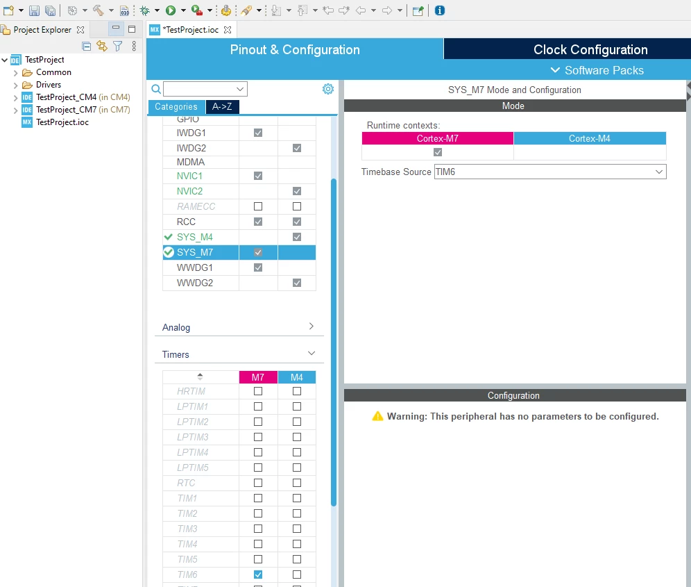

Haithem Rahmani
Dec 15, 2021 3:57 PM UTC
this screenshot was taken from STM32CubeIDE 1.8.0, the TIMER 6 is correctly selected as time source for CM7

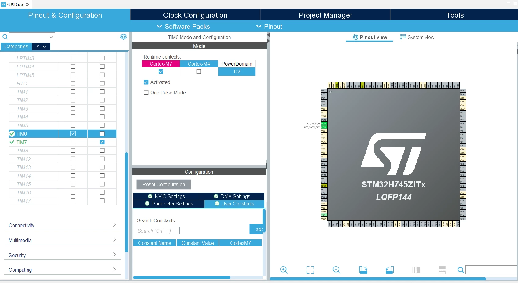

0693W00000HookCQAR.pngHello ,
I install the latest version 1.8.0.I am sharing the snap shot 0693W00000HoogyQAB.png0693W00000HoogoQAB.png,it doesn't give me the selection for TIM6.
Haithem Rahmani
Dec 16, 2021 10:14 AM UTC
it is because you checked the "Activated" Checkbox, that option means that you want to use the TIM6 at your application, unselect that option and this will be fine.
