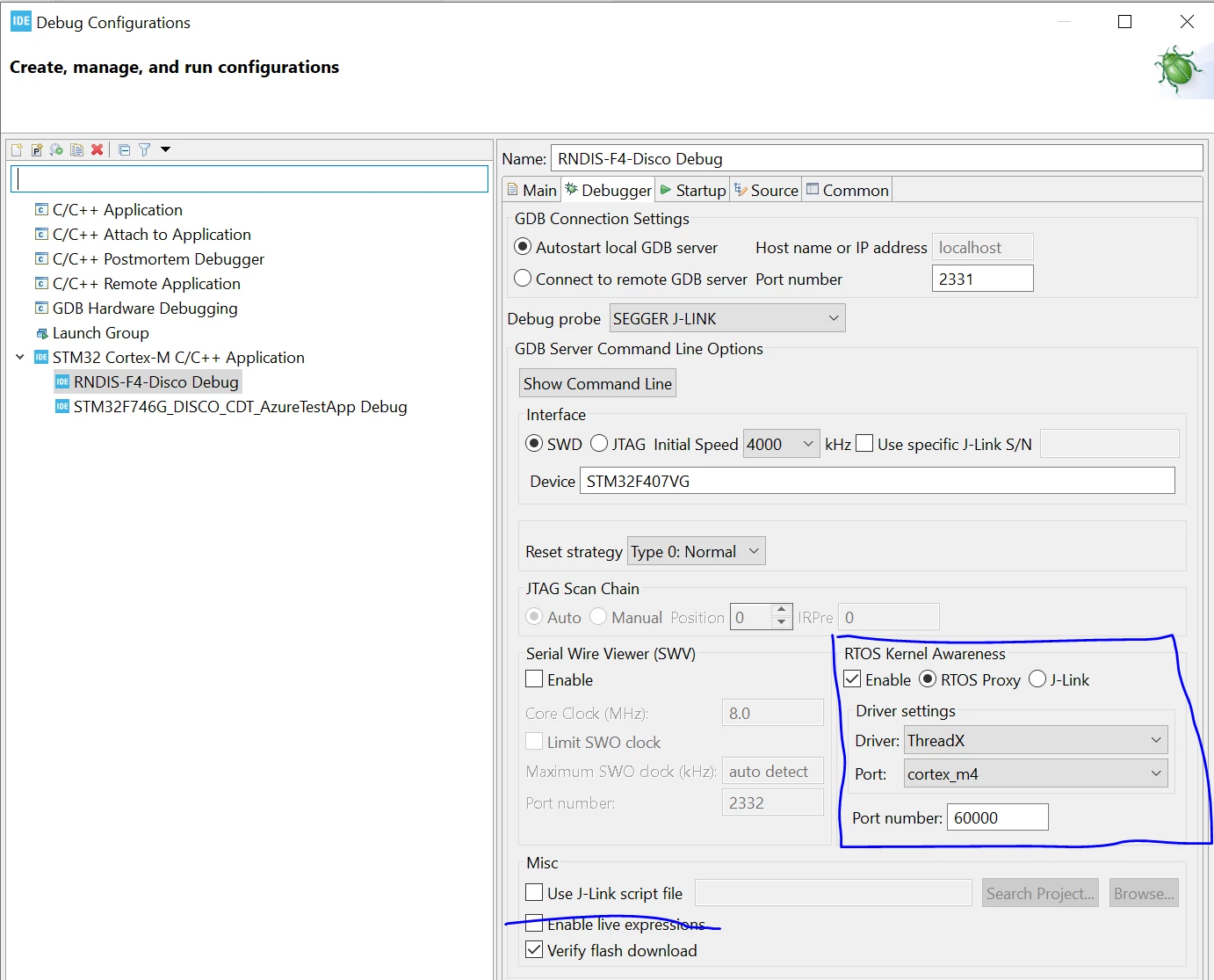

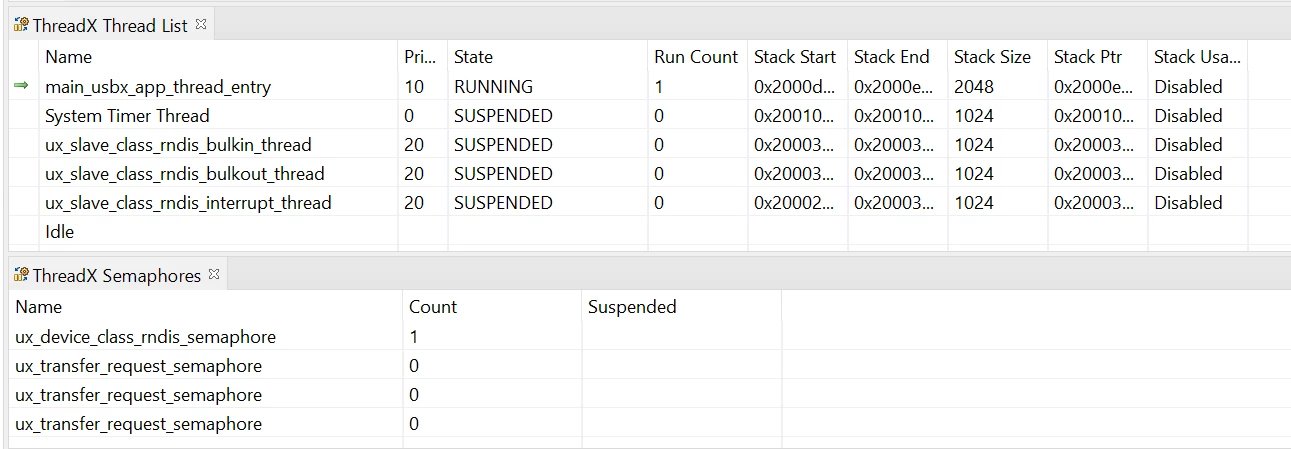

Some information sharing in case others want to learn. CubeIDE contains RTOS debug tools for ThreadX.
Window > Show View > ThreadX > ThreadX ....
These views works with any debugger back-end without having to set any check-boxes in the debug configuration. There are however some #defines required in order for ThreadX to build the kernel with the right hooks. See CubeIDE user guide. But should be OK for CubeMX generated project and Microsoft GitHub examples too..

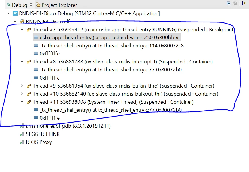

If you need to examine the stack of all existing threads in the RTOS (inspecting local variables etc), you can enable the RTOS Proxy in the debug config. Word of caution. This feature is currently conflicting with Live Expressions feature. So these features are right noe mutually exclusive. Work on-going...
The feature also works for any debug back-end. Segger in your case...
Enable like this RTOS Proxy:
When doing so the Debug view, Variable view, Registers view, etc will show thread context related data.
Hope these features help to learn how to use ThreadX and the various thread synchronization mechanisms.
