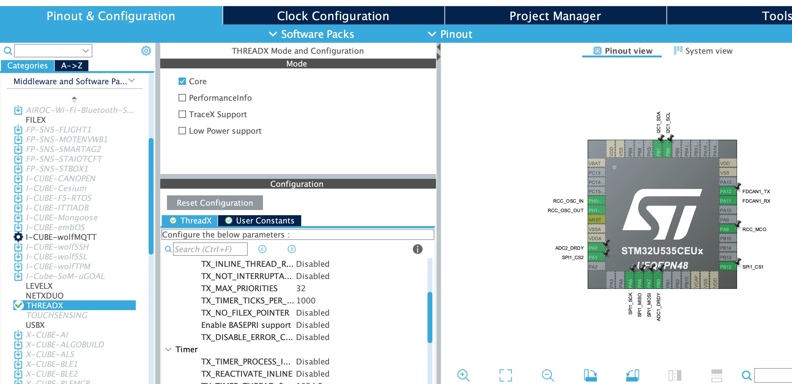

I am running an application with Azure RTOS, and CAN bus.  All was well until I needed to increase the tick time to 2000/second (from 1000/second).  When I did this the CAN Interrupts stop working. To make things even worse, when I change the tick time back to 1000/sec within CubeIDE, it still doesn't work and I have to pull and older version off Github to get it going again.  I'm not overly familiar with Azure RTOS, usually I just do my own OS.  CAN interrupts are priority 0, RTOS 15.  TIM6 is used for tick for RTOS.

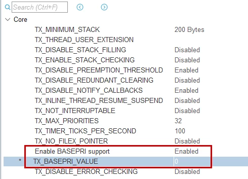

Haithem Rahmani
Oct 24, 2025 8:15 AM UTC
Hi @Rob Ashworth
Try to configure ThreadX to use the BASEPRI register, as shown below:
set the 'TX_BASEPRI_VALUE' to a value different from 0, then the CAN interrupts won't be masked.
regards
Haithem.
