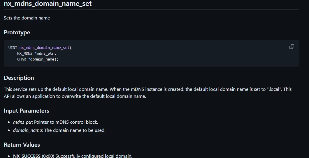

I am using Azure RTOS with NetxDuo, I implemented a secure https server in my device and implemented mDNS which was working very well for me till I required to change domain. I want to add a sub-domain like (myhostname.mysubdomain.local). In documentation it is stated that by default the domain is .local but can be changed using following API

status = nx_mdns_domain_name_set(&mdns_instance, "home");
status = nx_mdns_enable(&mdns_instance, PRIMARY_INTERFACE);
It returns success and according to the document I must be able to ping hostname.home but thats not the case not matter what I done it will be always accessible through hostname.local
I checked the domain name buffer inside mdns_instance, its updated to home but even then changed domain is not accessible.

Hello @faharintisar ,
After giving it some thought, I think that this could be a problem not relaled to your MCU setting this. home instead of .local but this can be explained maybe by devices on the network still memorizing the last names in mDNS cache.
So, try clearing any mDNS cache on the devices you are using to test the domain name resolution. Cached entries might still point to the old domain.

sorry to hear this another suggestion maybe to use the API call as follows:
status = nx_mdns_domain_name_set(&mdns_instance, "hostname.home");
