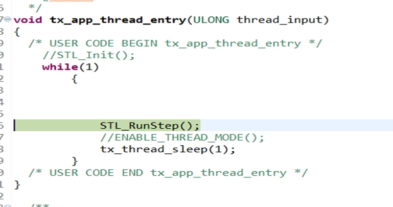

Hi team,

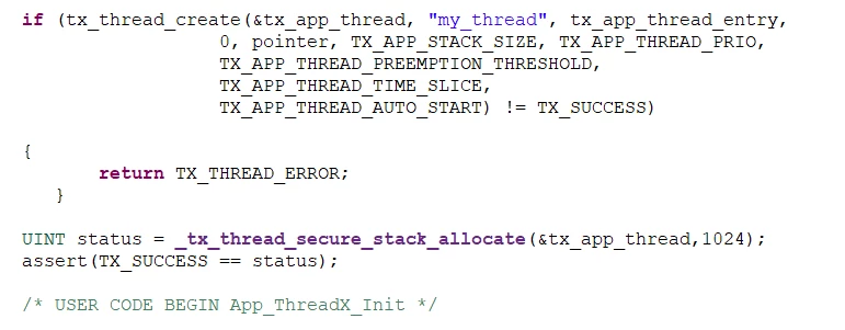

1. Class B Test Library test With Trustzone Threadx .
2. Class b Thread allocate to Secure mode.
_tx_thread_secure_stack_allocate

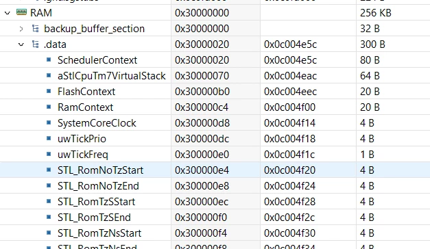

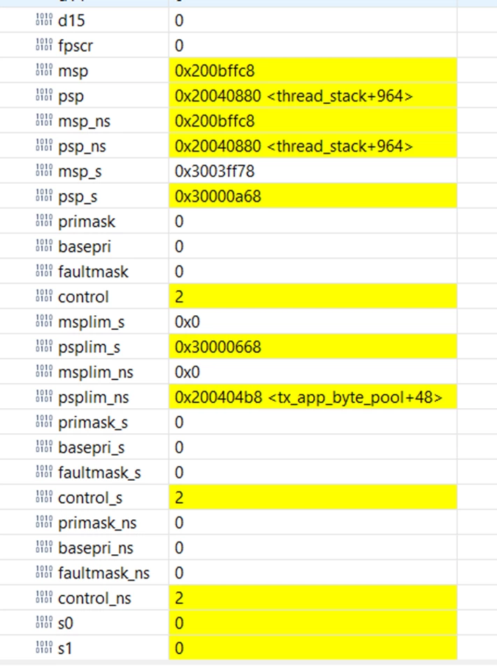

3.After secure stack allocation PSPLIM_S=0x30000688 Value Stack overflow.
Virtual stack start address: 0x30000070
STL lib start address: 0x300000b0
When performing the “push r3” content on “current PSP 0x300000b0” the device generates a hard fault and the reason is Stack overflow.
Question:
1. how to clear Stack PSPLIM_S overflow in Azure RTOS secure allocation?
