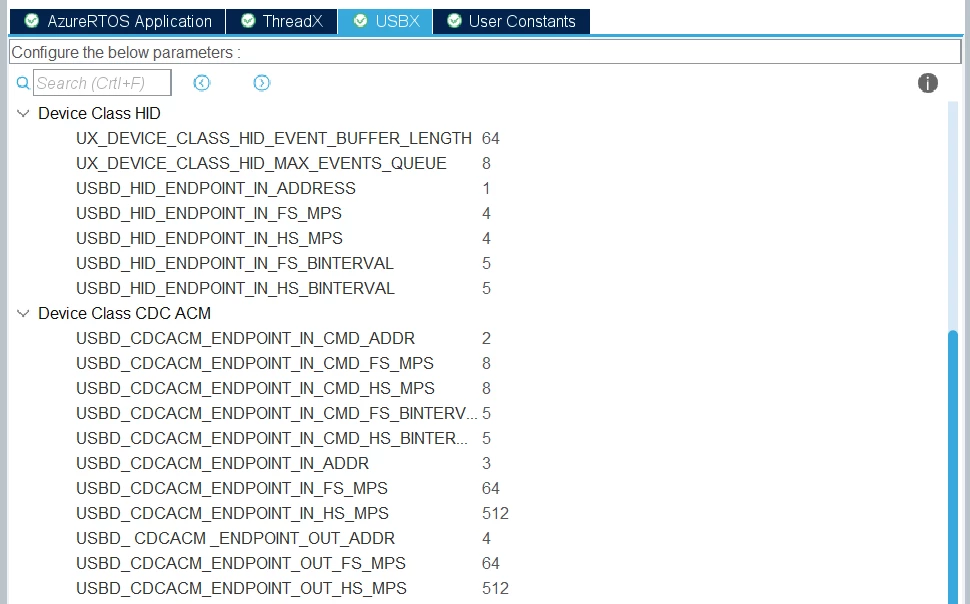

I am working on nicleo-h745ziq board according to this video https://youtu.be/wCRIpp-OHY4 i follow the steps biut USB is not get detected why? also I create project for Ux_Device_CDC_device but also in this example usb detection is failed why this happend? i try simple USB CDC as virtual comport is works fine can you please help there is any support for only AZURE RTOS

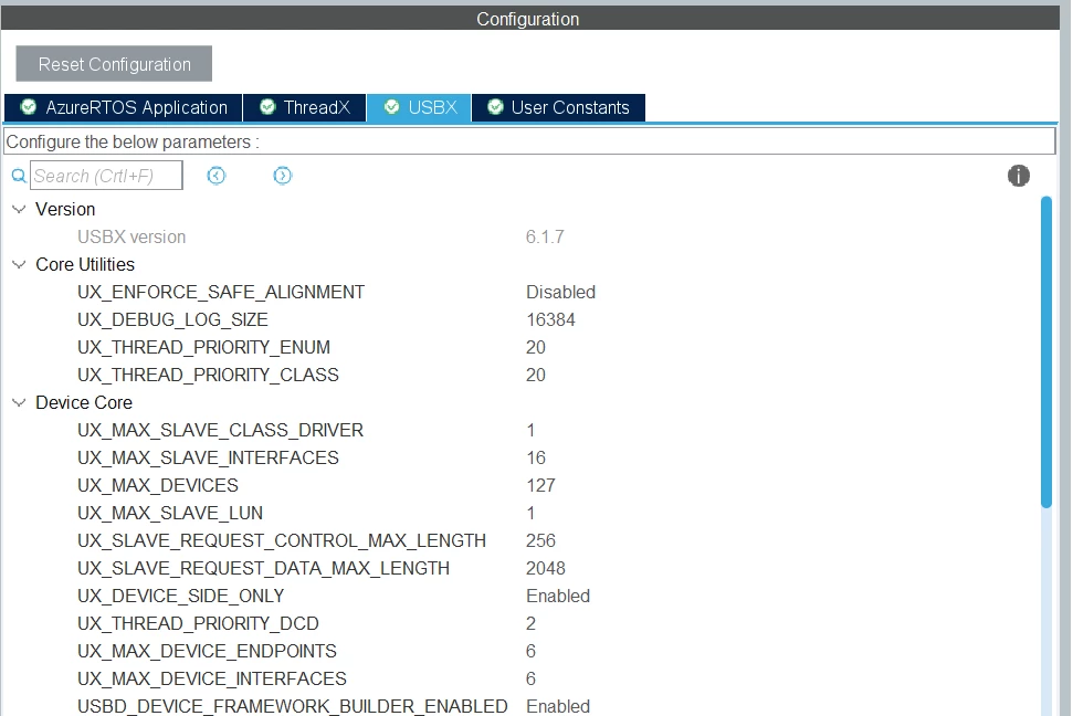

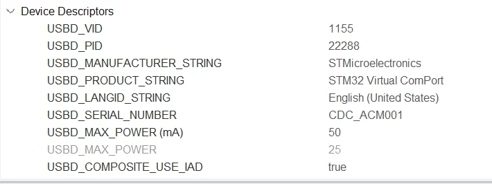

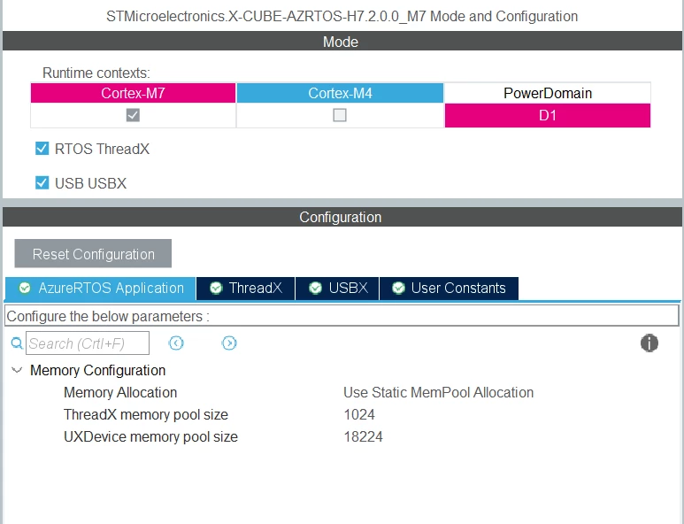

MDeva.1
MDeva.1Author
Jun 17, 2022 11:32 AM UTC
0693W00000Ns5WwQAJ.png0693W00000Ns5ckQAB.pngI make these following configuration this is right or wrong ,which paramter i have to change?0693W00000Ns5eLQAR.png0693W00000Ns5VjQAJ.png

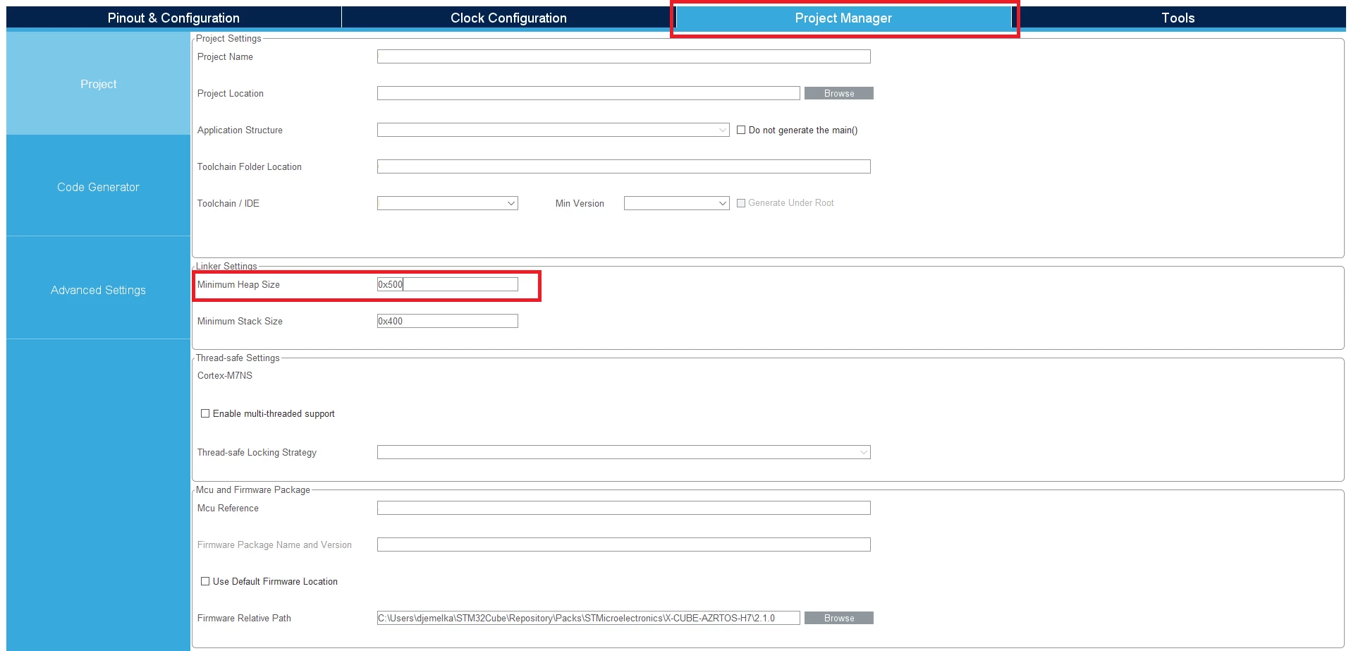

KDJEM.1
Jun 17, 2022 1:06 PM UTC
You can change the heap size in the project manager to 0x500 as shown in the below figure.0693W00000Ns7JyQAJ.pngKaouthar
mohamed.ayed
Jun 17, 2022 1:21 PM UTC
@MDeva.1 ​Could you please verify your endpoint config?
