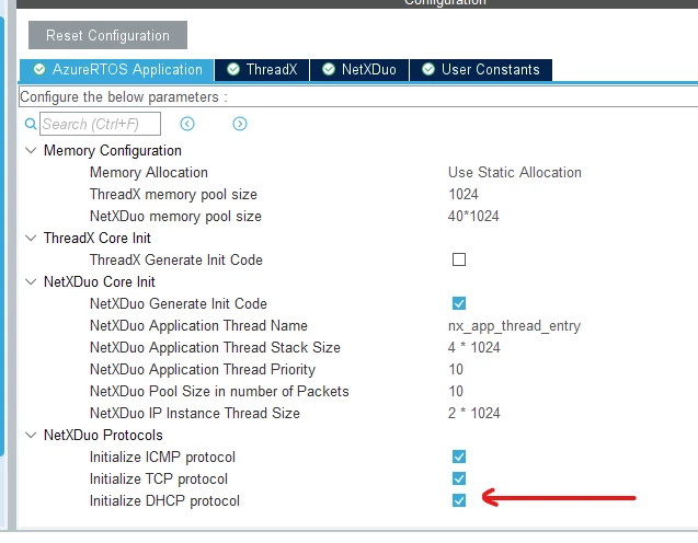

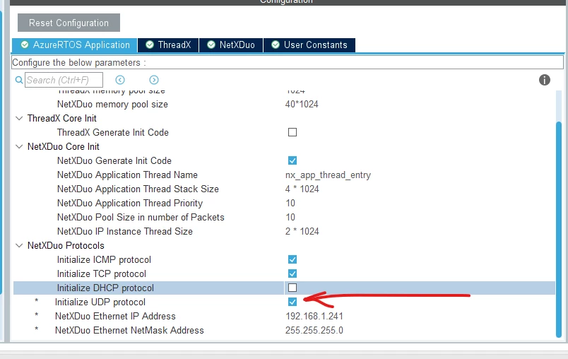

I am trying to enable both DHCP and UDP in my Azure RTOS NetXDuo application, but when I enable DHCP the UDP selection is hidden, and vice versa. Why is this happening?

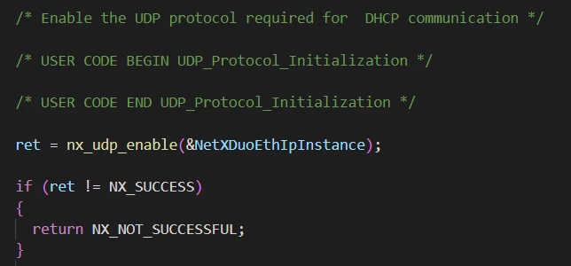

DHCP protocol is using UDP to send requests, so when the former is enabled the latter is too.
please check the generated code when the DHCP is enabled you'll notice something like.
0693W00000aJiNLQA0.pngregards

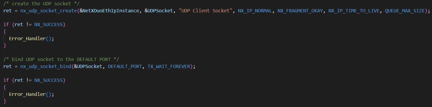

you'll need to create an UDP socket first then bind it to listen to specified port as below:
0693W00000aJqgNQAS.pngplease refer to the Nx_UDP_Echo_Client for more details.

Thanks Haithem. So I assume there is no way to set the UDP port within the CubeIDE GUI?
Haithem Rahmani
Mar 28, 2023 12:28 PM UTC
Hi @Community member​
Indeed, the parameters exposed in the STM32CubeMX UI are only to initialize and configure network protocols, and don't deal with any applicative scenario.
you can always use one of the provided example as reference to build your own application.
