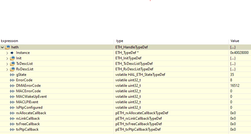

I'm using a STM32H7 with a NetXduo web server example. I implementend a http get endpoint to get some data and a http put endpoint to reset the mcu. Sometimes, after the reset, the network stops to work. The http get, put and even the ping doesn't respond. The others threads continue to working fine
It appears that this problem is more frequent when I send a get or a put immediately after a reset, but it can be only my impression. How can I debug this problem? I'm a novice on Azure RTOS.

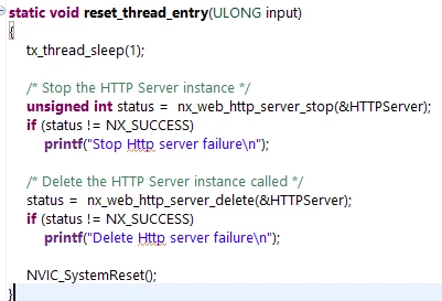

Could you please provide the reset process you are using? Also, could you provide the Ethernet handle state when the issue occurs?

The process use NVIC system reset.
The ethernet handler shows an error on DMA

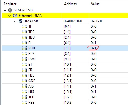

The DMA error appears on ethernet handler even when the application works. On the SFRs its possible to see the RBU bit. This bit indicates that the application owns the next descriptor in the Receive list, and the
DMA cannot acquire it. Why this is happening?
I putted the SCB_CleanInvalidateDCache at the program beginning, but has not effetc.
You're going to reset anyway. Disable the ETH and its DMA after http_server_stop() ?
