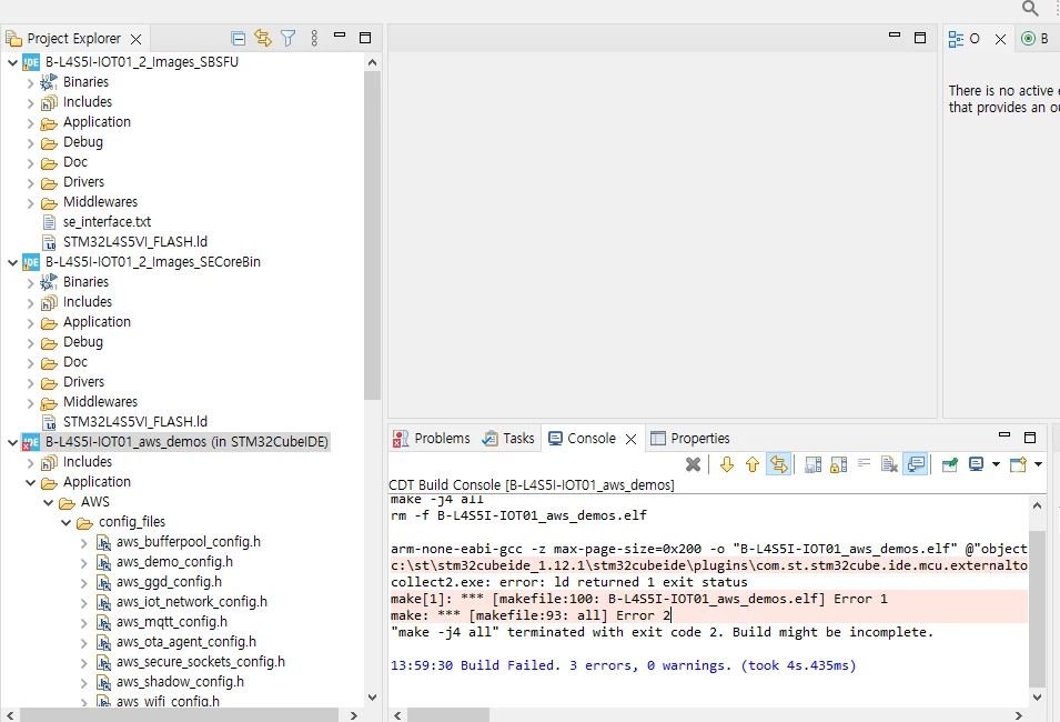

B-L4S5I-IOT01 보드를 사용하고 있으며, AWS Iot에 연결하는 과정을 따라하고 있습니다.
aws-demo 빌드시 오류가 발생하면 결함을 발견할 수 있는 방법이 도움이 되었습니까?
미리 감사드립니다.
https://catalog.us-east-1.prod.workshops.aws/workshops/b5857416-f2f6-4188-8562-053ec5f983ef/en-US/lab-0
> 불러오기 링크
>오류가 발생한 화면
(x-cube-aws 파일을 받을 때 추가로 관련된 파일이 문제,
하지만 파일은 더 이상 사용할 수 없습니다) (AWS에서 제공한 파일로 종료하기)

Could you precise which X-CUBE-AWS version are you using?
Could you please check the build order indicated in the readme file?
Could please share the full error build message you received?
Kaouthar

First of all, thank you for your answer.
For now, I built it in the order of the build shown in the file.
And the X-CUBE-AWS version is 2.0.0.
And this is an error message that occurred when installing the aws-demos file.
>>> c:\st\stm32cubeide_1.12.1\stm32cubeide\plugins\com.st.stm32cube.ide.mcu.externaltools.gnu-tools-for-stm32.10.3-2021.10.win32_1.0.200.202301161003\tools\arm-none-eabi\bin\ld.exe: cannot use executable file '../../../../BootLoader_STSAFE/2_Images_SBSFU/STM32CubeIDE/B-L4S5I-IOT01_2_Images_SBSFU/Debug\se_interface_app.o' as input to a link
collect2.exe: error: ld returned 1 exit status
make[1]: *** [makefile:104: B-L4S5I-IOT01_aws_demos.elf] Error 1
make: *** [makefile:97: all] Error 2
"make -j4 all" terminated with exit code 2. Build might be incomplete.

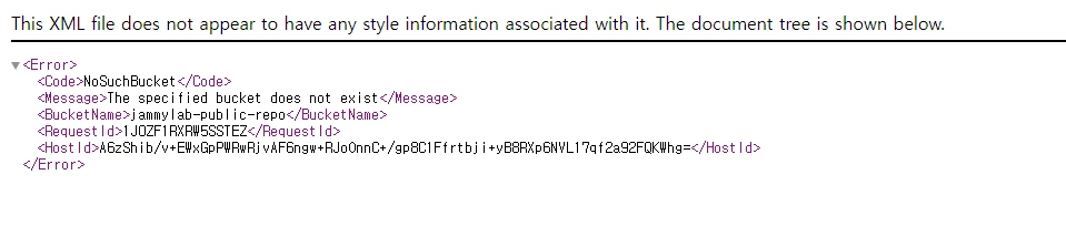

And I attached the wrong site that I am referring to.
I'm following the process on this site.
>>> https://master.d2s409snhlt74e.amplifyapp.com/
And this is the error picture of the additional installation code file of aws. ( No. 4 in the environmental configuration phase of Exercise 0)
