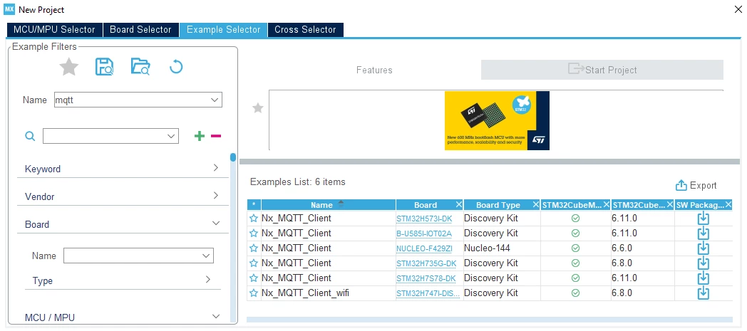

The users who prioritize the CubeMX ease-of-use over the feature completeness of the application example may be interested in a simpler MQTT/S connection to a generic MQTT broker (without TLS mutual authentication, without FreeRTOS OTA, nor ready-to-use support of device shadows or jobs), and try out some MQTT examples based on ThreadX+NetXDuo: They can be listed in the CubeMX Example Selector by filtering on the "MQTT" example name or keyword.
CubeMX filter screenshotCubeMX filter screenshot
