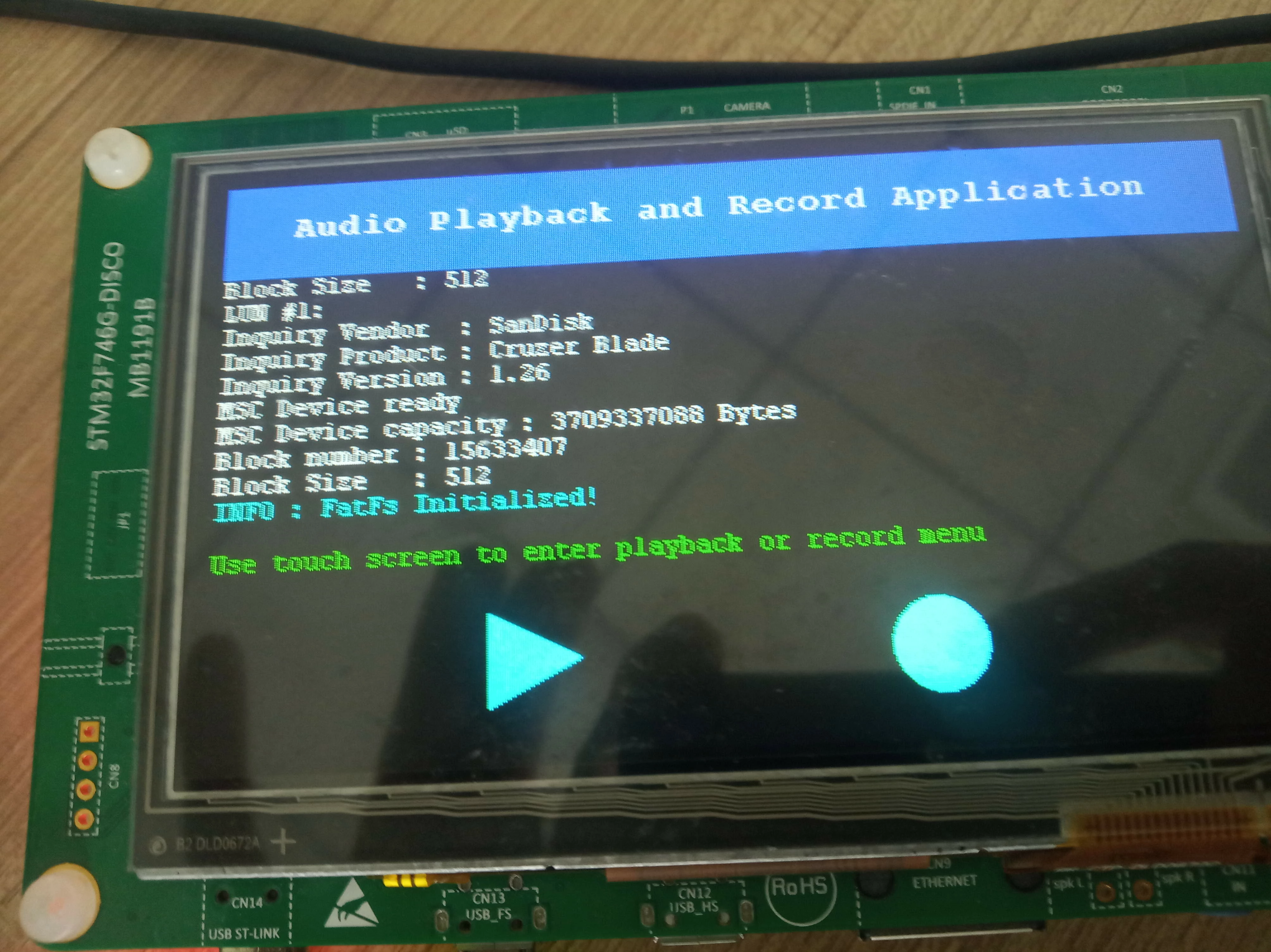

Hi All,
I am trying to run Audio playback and record application present in the path:
STM32Cube_FW_F7_V1.15.0/Projects/STM32746G-Discovery/Applications/Audio/Audio_playback_and_record/SW4STM32/STM32F7-DISCO
But it hangs inside "FRESULT AUDIO_StorageParse(void)" function at line : "res = f_opendir(&dir, USBKey_Path);"
Could you please help me with this.

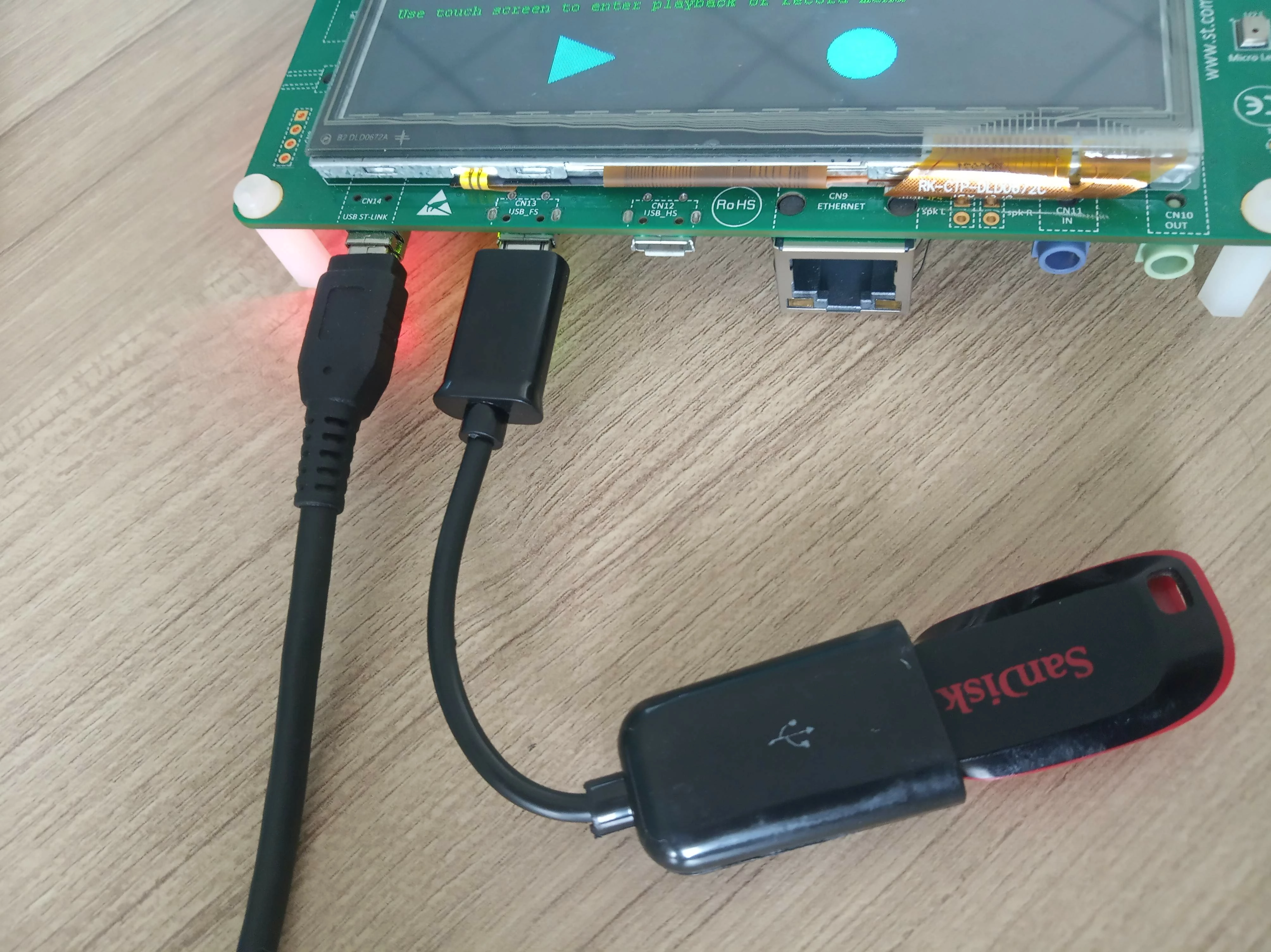

  4. board setup:
    1. USB pendrive with file.wav is connected to USB_FS of the board via USB to micro USB converter.
    2. Entire setup is attached as pic to this post.
    3. USB pendrive: SanDisk, 8GB.
Steps followed:
  1. Open audio application present in "STM32Cube_FW_F7_V1.15.0/Projects/STM32746G-Discovery/Applications/Audio/Audio_playback_and_record/SW4STM32/STM32F7-DISCO" in eclipse.
  2. Build and run.
  3. It prompts on the LCD - "Use Touch button to enter playback or record menu".
    1. Not touch the screen anywhere. It is expected to display the file list to be played.
  4. But program is getting struck inside "AUDIO_StoragePars()" function at line "res = f_opendir(&dir, USBKey_Path);". It tries to open the directories in USB pen drive and never comes out.
  5. Tried with different USB pendrives, But no luck.
  6. As explained in the board setup,
    2. Also tried connecting USB pen drive to USB_HS. But same result. No luck.
It must be connected to USB_FS, connector CN13, as is in your picture.
