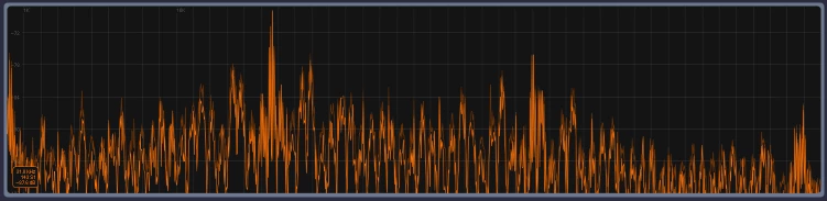

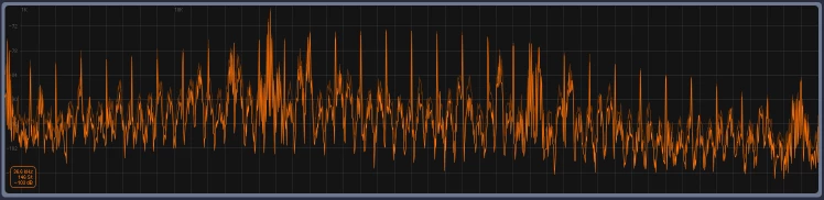

Hi! I am using STM405RGT6 and TI PCM3060 audio codec. I use DMA to RX and TX I2S data. I2S configured to 96000 Hz.
When I set buffer size, for example, 64 samples I get parasitic frequency peaks at every 1,5 kHz (96000/64 = 1500) - 1.5 kHz, 3 kHz, 4.5 kHz... If I set buffer size 256 samples I get parasitic frequency peaks at every 375 Hz and so on. Level of this noise is about -60 dB. I am just send recieved data back to codec, not using any processing.
How can I remove this noise?

update:
Maybe it will help to recognize the reason of the noise: If I set DMA_PeripheralBurst to ''DMA_PeripheralBurst_INC16'' instead of ''DMA_PeripheralBurst_Single'' noise peaks becomes lower by 10 dB.
I was wrong. Even if I send zeroes to codec (checked with oscilloscope) I hear noise.
