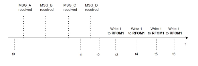

Suppose 4 CAN data frames arrived and they were all stored into FIFO1. Then CPU wrote 1 to RFOM1 for 4 times. This procedure is showed in figure1.
figure 1
We focus on 7 specific moments t0, t1, t2, t3, t4, t5, t6.
We assume that in t0 the FIFO1 is empty, i.e, FMP1[1:0] in CAN_RF1R is 00b. And FIFO lock function is disabled.
I hope someone could confirm whether the following statements are true.

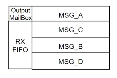

1.The mailbox and 3-level FIFO(Only FIFO1 is used and FIFO0 is excluded in our discussion.) can store up to four different data frames.
2.At t1, FMP1[1:0] in CAN_RF1R is 11b.    FULL1 is 1.
The message distribution should seem like figure2.
figure 2
3. At t2, FMP1[1:0] in CAN_RF1R is 11b.    FULL1 is 1.
The message distribution should seem like figure3.
figure 3
 4.After t3, FMP1[1:0] in CAN_RF1R is 11b.     FULL1 is 1.
The message distribution should seem like figure4.
figure 4
 5.After t4, FMP1[1:0] in CAN_RF1R is 10b.     FULL1 is 0.
The message distribution should seem like figure5.
figure 5
6.After t5, FMP1[1:0] in CAN_RF1R is 01b.     FULL1 is 0.
The message distribution should seem like figure6.
figure 6
7.After t6, FMP1[1:0] in CAN_RF1R is 00b.     FULL1 is 0.
The message distribution should seem like figure7.
figure 7
8.Atomicity/ Data Consistency of output mailbox is guaranteed. Though the RX FIFO may be over written by new data frames(if FIFO lock is disabled).
