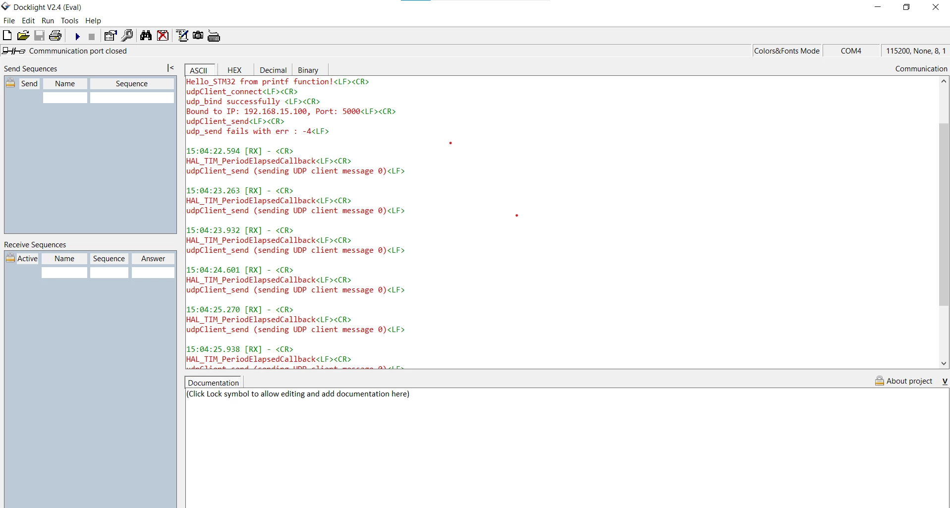

However, I am facing an issue:
- When I first call the udpClient_connect function from the main function and attempt to send data using the udp_send function, it returns an error code -4.
- After the first attempt, subsequent calls to udp_send do not return errors, and the function executes successfully.
- I am sending data at 1-second intervals, but I am unable to see the data on the Hercules tool.
Here is screenshot of the debug log printed on Docklight.
I have attached my project for your reference.
Could you please help me understand why the initial error occurs and why data is not visible in the Hercules tool?
Thank you for your assistance.

Mehulrana511Best answer
Jan 4, 2025 4:20 AM UTC
Hi @STea ,
Thank you for your support! I have resolved the issue. The problem was on the hardware side of the STM32H7S78-DK Discovery board. To enable Ethernet functionality, modifications were required in the default solder bridge configuration:
  • PC1 needed to be closed.
  • PB2 needed to be open.
These adjustments resolved the issue successfully.
Best regards,
Mehul
