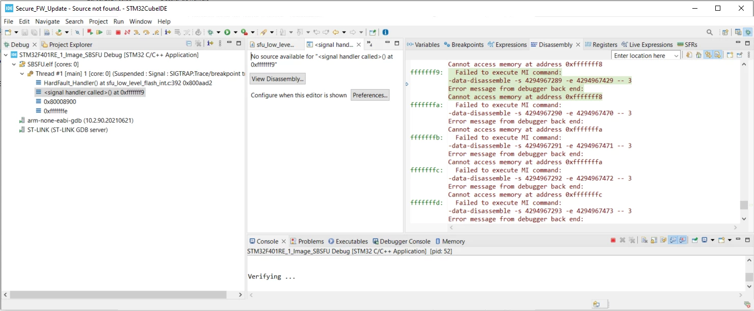

I got this assembly code (see below) in an ST example code on secure boot and  and I don't understand some lines :
  • why do we have to push R1 five times in a row?
  • why is LR set to 0xFFFFFFF9? That is causing a hard fault at run
Does anyone have better understanding?

It is what I'd characterize as a "call gate" it determines how the MCU unstacks the processor context.
Depending on the patterns, it picks one stack or the other, and unwinds the NVIC depth.
Perhaps look a one of Joseph Yiu's Essential Cortex-M books, or ST's Programming Manuals, or the ARM TRM

Thanks for the tip, I read Joseph Yiu's book and understood better the call gate mechanism.
I still have a problem with the line 21 :
MOV LR, #0xFFFFFFF9 /* set LR to return to thread mode with main stack */
 For a reason that I don't understand , #0xFFFFFFF9 is being considered as an address and branching to it is causing  the hard fault. See capture attached.
Does any one have a clue why #0xFFFFFFF9 is being considered wrongly as an address?
