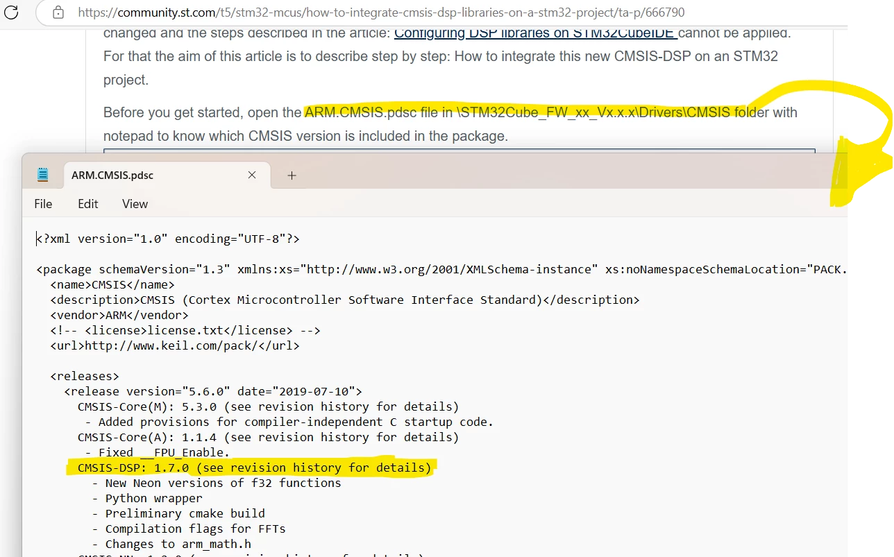

I'm using STM32Cube_FW_H7_V1.12.1 but I can't see how to determine which version of CMSIS-DSP that includes (having searched include files for a define, which I'm sure must be hidden there somewhere!).

I think I found the answer to my own questions. The CMSIS version distributed with H7 is defined as instructed here:
So it turns out that the DSP library is very old indeed, evidently the missing functions have been added at a later stage, the current version being 1.16.2.
This is worth noting for anyone using CMSIS-DSP - best not to rely on the H7 repository if you want the latest and greatest, since there will no doubt be bug fixes as well as enhancements in the latest version (as @AScha.3 , mentioned, available in github).

just look on git.. CMSIS-DSP 1.16.2
https://github.com/ARM-software/CMSIS-DSP
-> arm_status arm_rfft_init_512_q15(arm_rfft_instance_q15 * S);
