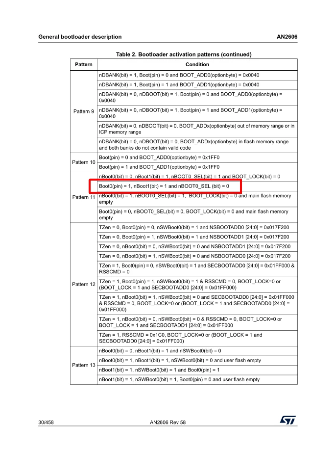

AN2606 Pattern 11 ('G0, 'C0) and BOOT_LOCK
AN2606 in description of Pattern 11 entry combination appears to indicate, that there's one combination when BOOT_LOCK option bit is ignored:

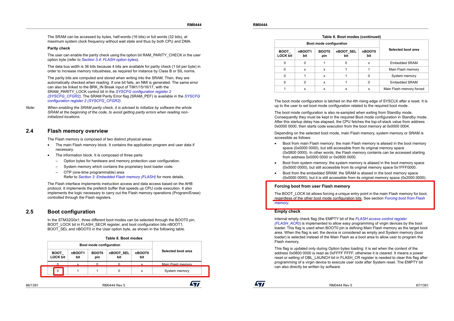

_legacyfs_online_stmicro_images_0693W00000bjXEiQAM.pngHowever, this contradicts the RM:
_legacyfs_online_stmicro_images_0693W00000bjXEnQAM.pngCan ST please clarify.

May 8, 2023 5:17 PM UTC
Hello @Community member​,
Thank you for sharing this point.
This is an issue on the AN2606, and I escalated this internally for correction.
An internal ticket ID 151513 is submitted in order to correct the AN2606.
(PS: ID 151513 only for reference, not available outside of ST)
Thanks
Imen
