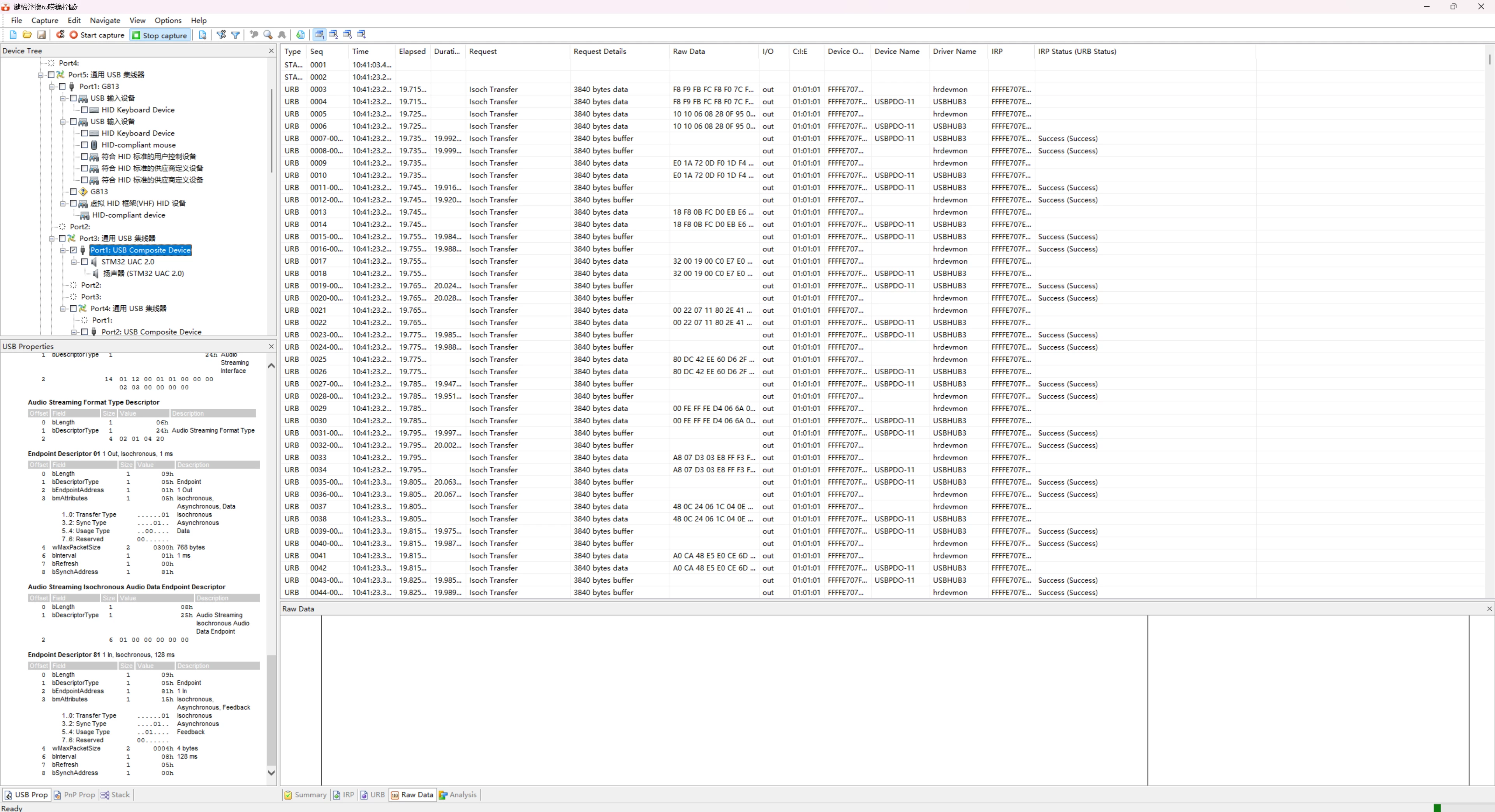

An exception occurred when transplanting Ux_Device_Audio_2.0_Standalone of STM32WBA6
Thank you for taking the time to review my question.
I migrated the Ux_Device_Audio_2.0_Standalone of STM32WBA6 to STM32H503 and successfully enumerated using USB FS. However, out of 1000 entries into the USBD_AUDIO_PlaybackStreamFrameDone function per second, half are 4 bytes long and half are 384 bytes (audio stream). I monitored the data using USBlyzer and did not see any upload data (EP IN) from STM32H503. I don't know where these 4 bytes come from, and this issue has been bothering me for several days.

Replaced the Feedback endpoint with another endpoint to solve the problem, not using the same endpoint as the audio stream output.

HAL_PCDEx_PMAConfig(&hpcd_USB_DRD_FS, 0x81, PCD_SNG_BUF, 0x06C0);
I configured 0x81 for Feedback, but I didn't see the host issue  Isochronous transfer input request. The 4 bytes seem to come from USBX.
If 0x81 is not configured for Feedback, the UAC2.0 device cannot be enumerated properly.
