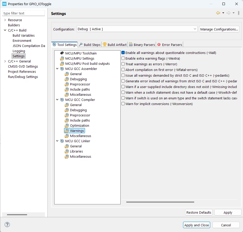

After upgrade to CubeIDE 2.0.0, HAL objects are being treated as the wrong TypeDef with STM32G4
I just upgraded to Cube 2.0.0 components. I did my first build in CubeIDE 2.0.0 with a previously working project and I got strange errors.  It appears the HAL objects for the peripherals are getting garbled.  When pointers to the objects are passed to functions, the compiler says that the pointer is of another peripheral type.  In the output below, the pointers to ADCs are treated like they are of the timer typedef.
What could cause this?

Pavel A.
Jun 30, 2026 11:46 UTC
The different (updated) compiler. You can use your previous toolchain with CubeIDE 2.x and avoid all these issues.
KHarb.1
KHarb.1Author
Senior
Jul 1, 2026 01:40 UTC
This was a from a change in compiler settings. I had a misconfigured pointer, but in previous versions it was a warning and luckily everything still worked. The latest version makes it a hard fault.
T_Hamdi
Jul 1, 2026 08:01 UTC
hello ​@KHarb.1
Yes, between different versions of CubeIDE, the compiler may change. Some warnings in one version can become errors in a later compiler version. I suggest checking the latest compilation flags and compiler settings.
