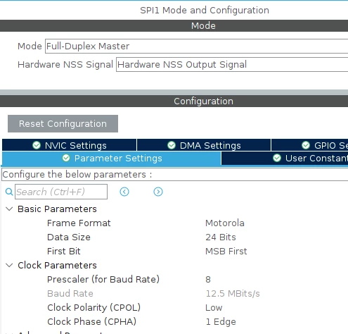

Jan 23, 2024 8:29 PM UTC
Ok, ADC msb first - you can set this in SPI parameters , like this:
ADC:
Should work.
tec683Author
Jan 23, 2024 9:32 PM UTC
I do have MSB set in the SPI but that is the bit order.  When I tried setting the SPI word length to 24, I got an error with the DMA using the FIFO.  I disabled the FIFO and got the configuration errors to go away.  Data was shifted out on the SPI but no change to the byte order.  Something to be aware of, I'm using a byte array and manually packing the 24 bit values into ie 3 bytes into the array.  I'm using HAL_SPI_TransmitReceive_DMA to transmit and receive the response. I'm not sure the DMA understand 24 bit word lengths.
I tried the CPU based blocking HAL SPI call to see if acts differently with 24 bits SPI length set.  Using a logic analyzer and looping the transmit into the receive, the bytes receives seem to be trying to be written as 4 byte integers (I speculate).  I'm sending out 0, 1, 2, 3, 4, 5, and so on. I see that as expected. I'm getting back 0, 0, 1, 2, 0, 4, 5, 6 and so on. With DMA, I'm seeing the output echoed back exactly.
