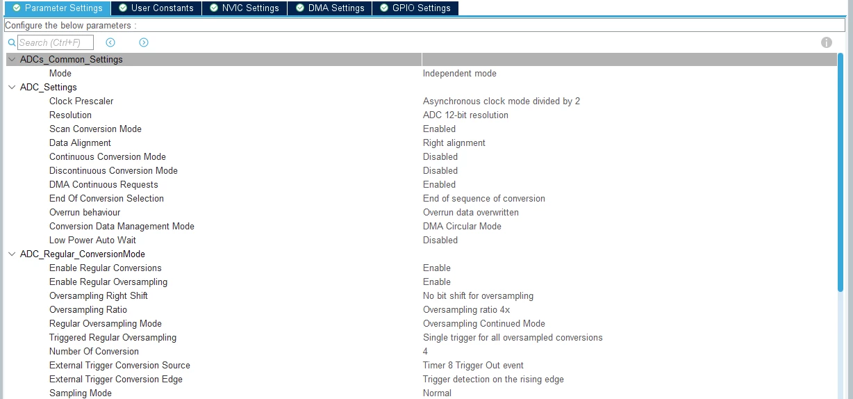

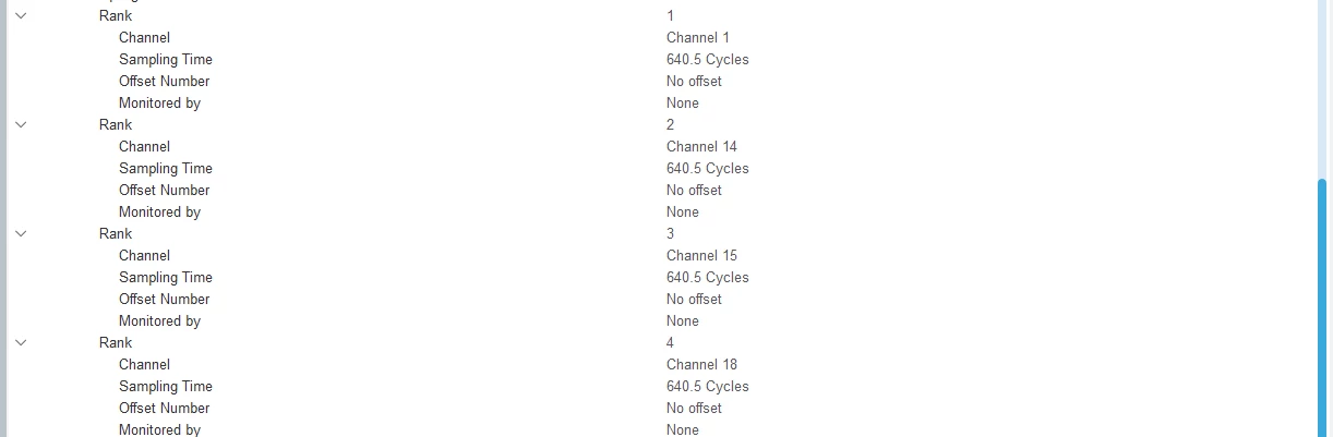

Hi ,
I have a board that has a STM32H562xxx , I have 4 analog inputs mapped on ADC1 IN1, IN14, IN15 and IN18 single ended … ( PA1, PA2, PA3,PA4 ), TRGO TIM8
I have DCACHE1 disabled
HAL_ADC_ConvHalfCpltCallback - gives a flag the cvt is completed
I have a uint16_t dmaBuffer[4]
When I run it the variable dmaBuffer[0..2] have values ~220 with small oscillations and only dmaBuffer[3]  with correct values from ADC1

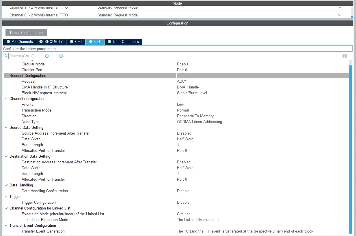

I’ve checked the GPIO PA1..PA4 the voltage is according to the potentiometer position for each PAx - It’s not a harware/wiring issue.
I assume there is something with this GPDMA1 and may be it’s Linked list … I’m not familiar with these… I think tried everything I knew … I am supposed to just set ADC1 4 channels on a DMA … I’m so frustrated … It’s the 3rd day I’m fighting with this MCU ...

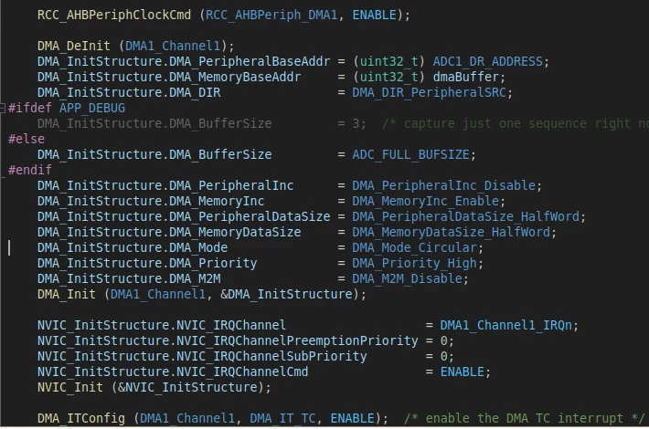

As mentioned, I don’t use Cube/Hal generated code, so I can only give more generic hints regarding DMA usage (assuming  the ADC DMA relation is similiar to the F4 devices).
Here a code xample for the F3. It is based upon SPL code, but you should recognize terms and DMA register values :
I suppose you get the picture - transfer size must be correct (HalfWord for 12-bit), peripheral increment disabled and memory increment enabled. Circular mode enabled means it repeats until you stop the timer/ADC.
Buffer size is the total number of items per transfer, in the configured data size (Halfword here), not bytes.
I use to have a multiple data sets transferred back to back (80 in this case), and get notified by the TC interrupt when the buffer is full.
Your HAL code should do basically the same, I recommend to check it.

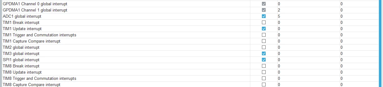

Let me share my config …
