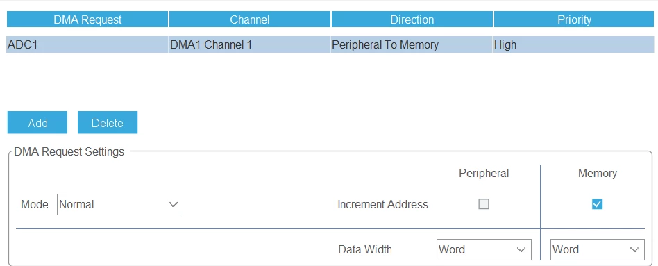

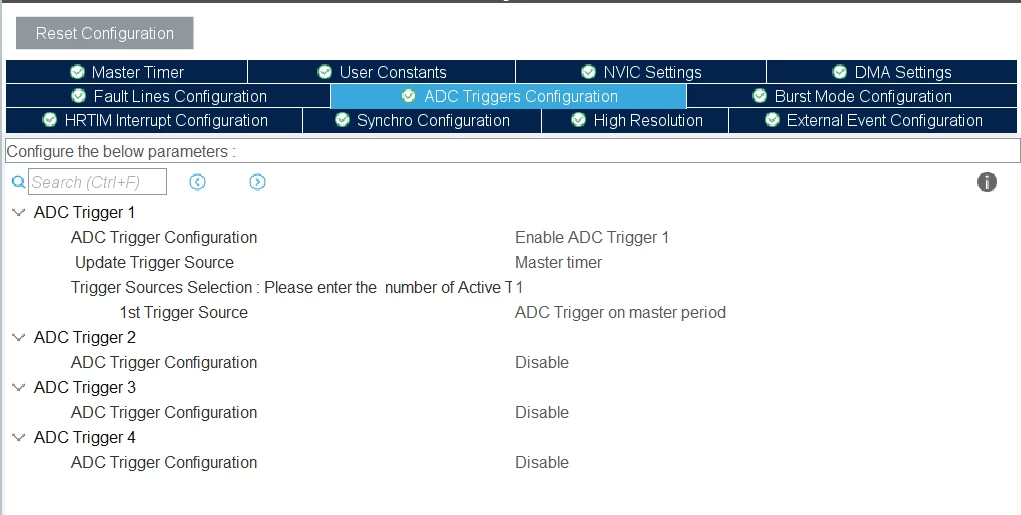

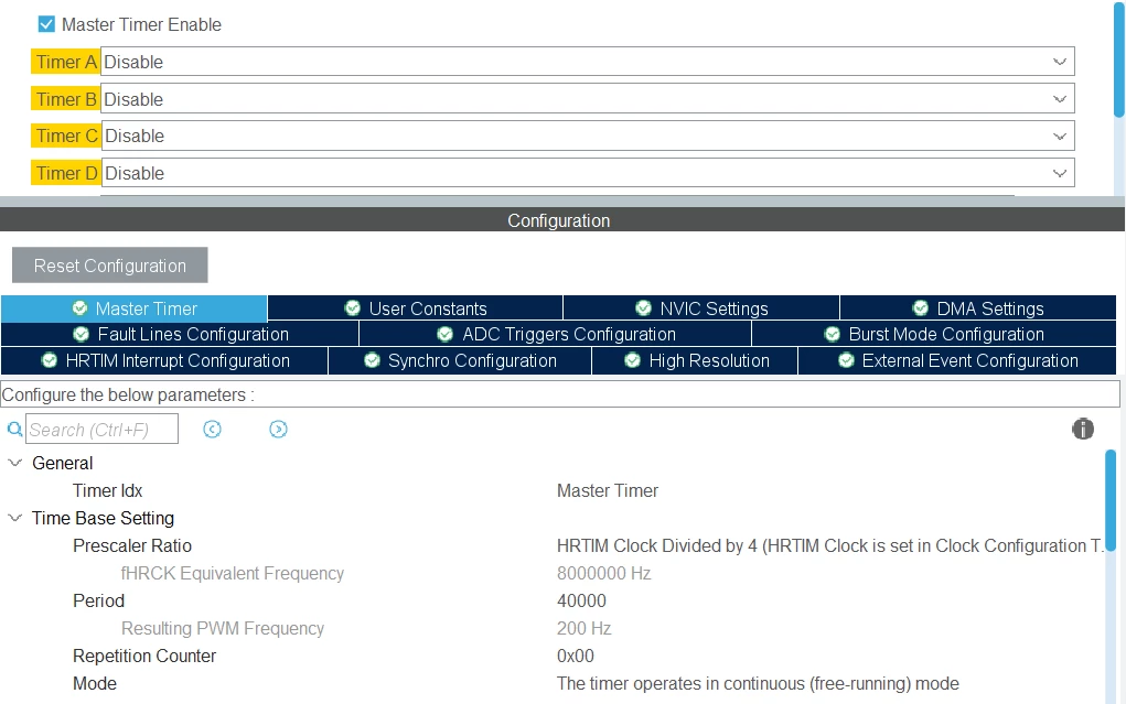

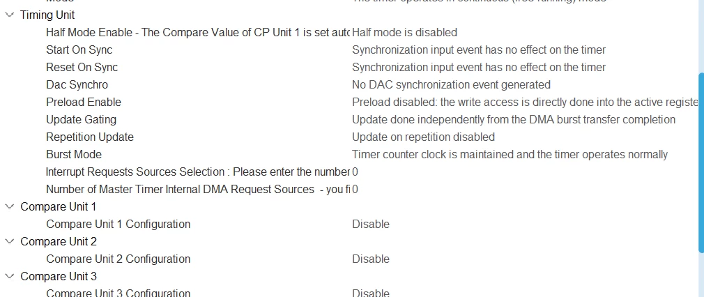

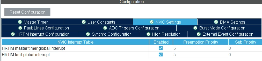

I'm trying to trigger ADC using an high resolution timer with period 500 KHz. The board is STM32F344. ADC is using DMA. I'm using FreeRTOS CMSIS V2. System clock 64MHz. So, two issues immediately came up:
1) After launching the timer using HAL_HRTIM_SimpleBaseStart_IT , all the tasks get blocked giving up the control to the HRTIM.
I lowered down the HRTIM period to 200Hz and the system got working again, although this behavior is weird: my tasks priorities are 24 and HRTIM 5. I tried to clear the update flag on the ISR handler as described in one of the posts here in the community but with no success. I always have troubles running hardware timers on FreeRTOS.

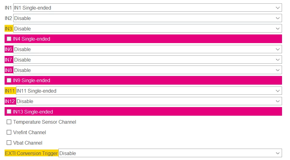

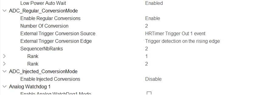

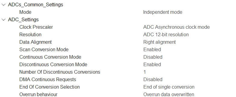

2) ADC conversions show up too fast and wrongly in the debugging window.
Although the conversions are being triggered too fast for a human or even the debugger, we can still see some readable raw data on the debugging window. My raw ADC measurements are swapping from 0 up to 100-ish very fast, but when I stop the code I see the correct value around 3000. The ADC clock is 2MHz. I tried many different configuration combinations but with no success.
I leave a code snippet, my ADC and HRTIM configuration and attached  the videos below.

ADC configurations

	 if(HAL_OK != HAL_ADC_Start_DMA(&hadc1, v_raw, 2))
		 Error_Handler();
	HAL_UARTEx_ReceiveToIdle_DMA(&huart1,usart1_rx_raw_buffer, USART1_BUF_LENGTH);
	main_app_handle = osThreadNew((osThreadFunc_t)main_app, NULL, &main_app_attributes);
	parser_task_handle = osThreadNew((osThreadFunc_t)parser_task, NULL, &parser_task_attributes);
void HAL_ADC_ConvCpltCallback(ADC_HandleTypeDef* hadc)
	if(hadc == &hadc1){
		HAL_GPIO_TogglePin(ENC_KEY_GPIO_Port, ENC_KEY_Pin);
		v_ = v_raw[0]*3.3/(4096.0f);
		if(HAL_DMA_STATE_READY == HAL_DMA_GetState(&hdma_adc1)){
			HAL_ADC_Start_DMA(hadc, (uint32_t*)v_raw, 2);

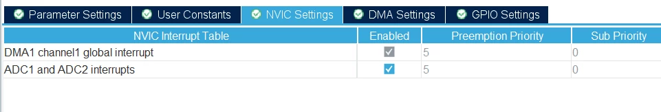

Hello @BentoCopi
I noticed that the NVIC priorities for HRTIM, ADC, and DMA are currently set to the same value. Please adjust these priorities according to the specific needs of your application.
In order to give better visibility on the answered topics, please click on 'Best answer' on the reply which solved your issue or answered your question. Saket_Om
BentoCopiAuthor
Dec 11, 2024 2:27 PM UTC
@Saket_Om I dropped down the priority for HRTIM up to 15 and the problem 1) got solved . Thank you for that!
The problem 2) persists. I set the priority for ADC DMA to 6 and just turned off the ADC global interrupts.
Dec 11, 2024 3:38 PM UTC
@BentoCopi
If the ADC global interrupts is turned off the HAL_ADC_ConvCpltCallback() will not be called.
