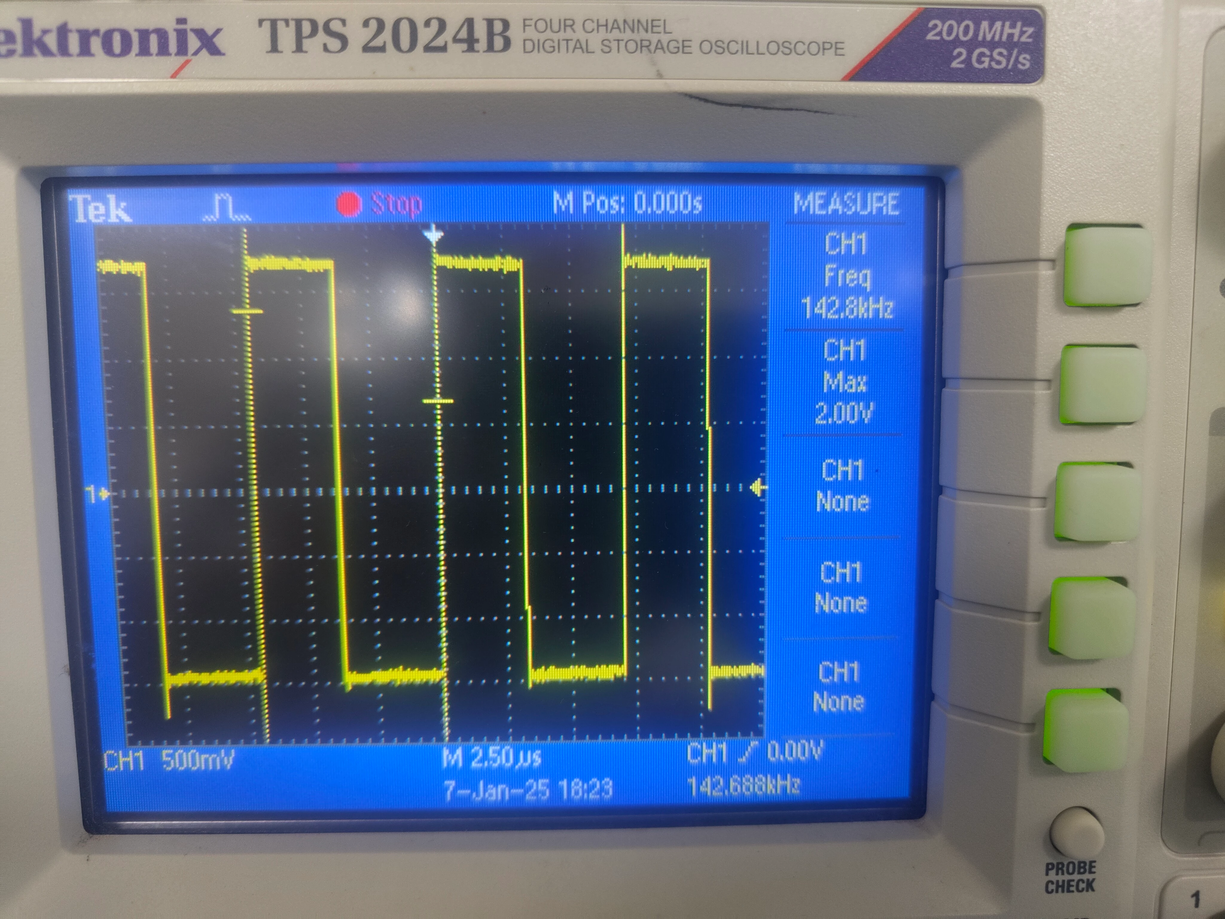

I agree that theoretical calculation may be wrong!.
Now as you the waveforms GPIO in the interrupt is toggling at the 142,8Khz attached image.
System clock is 170Mhz
  • Mode: IN1 Single Ended
  • Clock Prescaler: Synchronous Clock Mode Divided by 4
  • Resolution: 12 bits
  • Data Alignment: Right
  • Continuous Conversion Mode: Enabled
  • Sample Time: 2.5 Cycles
please help in understanding how I got this 142.8Khz
AScha.3
Jan 8, 2025 8:51 AM UTC
Well, i cannot know, what you doing...
so at first check, is your system running at xx speed : use MCO pin, set it to main clk /10 , or whatever, and look with a scope on MCO then; just to verify ,your cpu is running that speed, you expect .
Then look at ADC clock: what you set , going to ADC module ?
Then check, whats you do with ADC (read in manual...) , set to the mode (group conversion, single conversion etc.);
and the sampling time you set (dont use 2.5 , except your source is very low impedance; set 6.5 or 12.5 ).
-> calculate speed from ADC clock (/ divider) (/ sampling_time + 12.5 conversion_time) -> maybe:
-> 30MHz / 25 = 1.2 MHz . check it with your bit toggling.
Jan 8, 2025 8:37 AM UTC

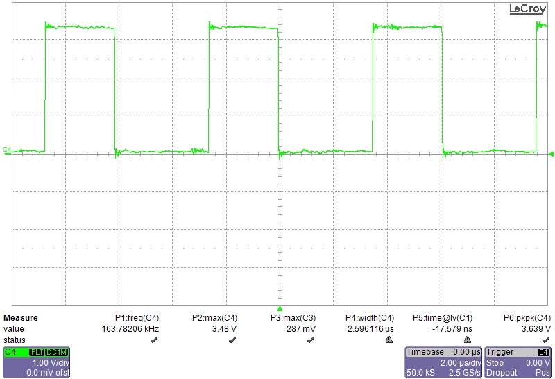

Hello
I am also facing the same issue in the same board :D , my code looks like
while (1)
HAL_ADC_Start_IT(&hadc1);
HAL_GPIO_WritePin(PA9_GPIO_Port, PA9_Pin, GPIO_PIN_SET);
void HAL_ADC_ConvCpltCallback(ADC_HandleTypeDef *hadc)
HAL_GPIO_WritePin(PA9_GPIO_Port, PA9_Pin, GPIO_PIN_RESET);
adcBuffer = HAL_ADC_GetValue(&hadc1);
ADC : 12 bit, single ended, 60Mhz(sychronous), ADC1 - IN1, 2.5 cycles sampling time, Fast channel
theoretically, it should be 250ns, but i am getti ng 2590nspollADC60mhy2.5cyclesnodelay.jpg
AScha.3

MasterT
Lead II
Jan 8, 2025 3:03 PM UTC
First, you've missed :
Sampling Rate=fADC /{ [sampling time(in cycles)] + [resolution (in bits)] +(0.5)}​
Substituting the values:
Sampling Rate=(170 MHz /ADC Prescaler: Synchronous Clock Mode Divided by 4)/ (2.4+12+0.5)  ≈  11.33 MHz
Second don't use interrupt , better way to verify sampling is to set array for adc samples and feed pwm with known frequency (confirmed with o-scope)  to adc input.
