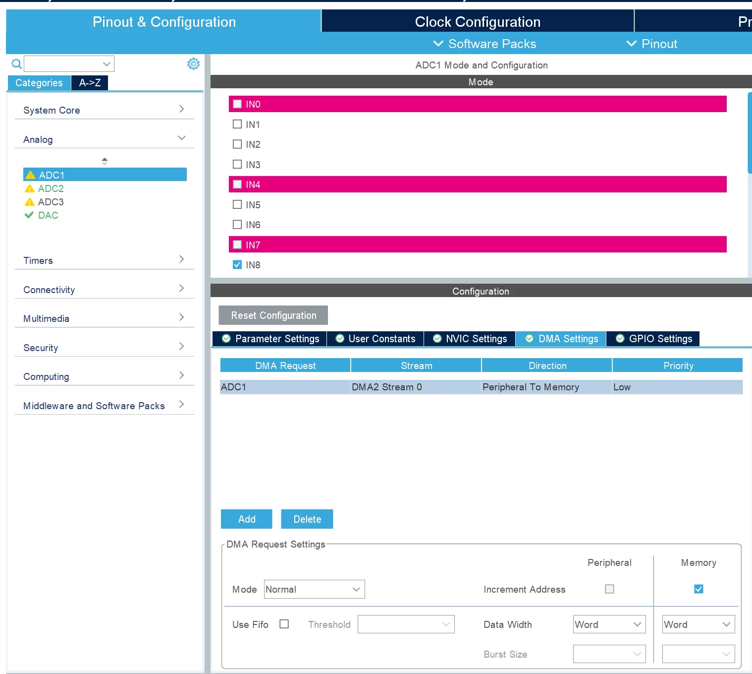

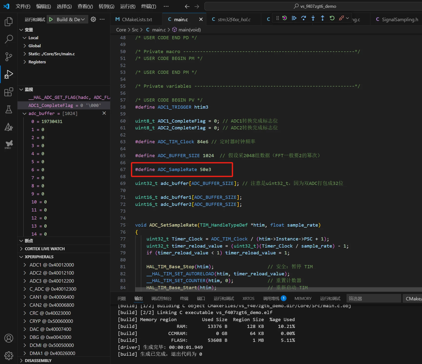

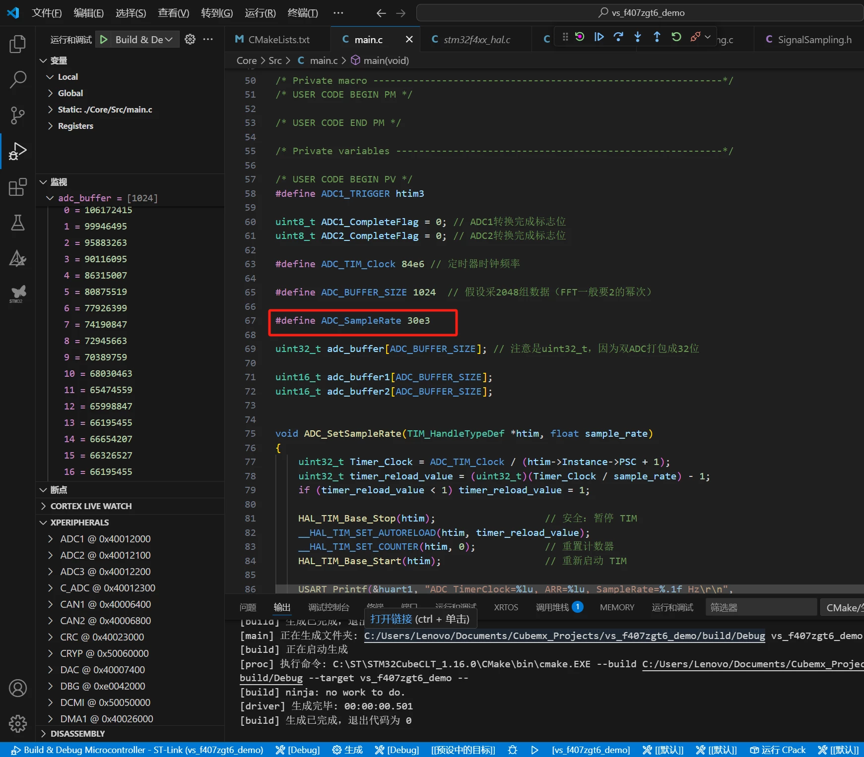

I wonder why I have data in the buffer when my sample rate is 30KHz and 0 when the sample rate is 50KHz.
My code:

#define ADC1_TRIGGER htim3
uint8_t ADC1_CompleteFlag = 0; // ADC1转换完成标志位
uint8_t ADC2_CompleteFlag = 0; // ADC2转换完成标志位
#define ADC_TIM_Clock 84e6 // 定时器时钟频率
#define ADC_BUFFER_SIZE 1024 // 假设采2048组数据(FFT一般要2的幂次)
#define ADC_SampleRate 30e3
uint32_t adc_buffer[ADC_BUFFER_SIZE]; // 注意是uint32_t,因为双ADC打包成32位
uint16_t adc_buffer1[ADC_BUFFER_SIZE];
uint16_t adc_buffer2[ADC_BUFFER_SIZE];
void ADC_SetSampleRate(TIM_HandleTypeDef *htim, float sample_rate)

 ADC_SetSampleRate(&ADC1_TRIGGER,ADC_SampleRate);
 HAL_ADC_Start(&hadc2);
 HAL_ADCEx_MultiModeStart_DMA(&hadc1,adc_buffer,ADC_BUFFER_SIZE);
 HAL_TIM_Base_Start(&ADC1_TRIGGER);

// ADC TimerClock=84000000, ARR=8399, SampleRate=10000.0 Hz
// ADC TimerClock=84000000, ARR=2099, SampleRate=40000.0 Hz
// ADC TimerClock=84000000, ARR=1679, SampleRate=50000.0 Hz
// 为什么采样率设置为50K时,主循环没有打印串口数据,DMA是normal模式,排除串口速度跟不上

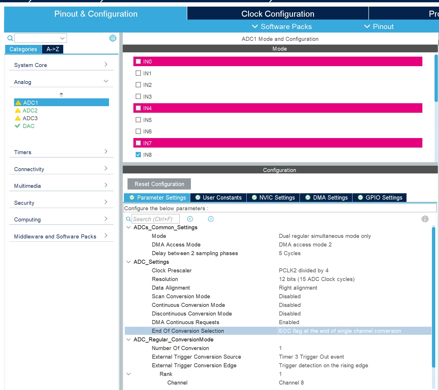

 ADC_MultiModeTypeDef multimode = {0};
 ADC_ChannelConfTypeDef sConfig = {0};
 /* USER CODE BEGIN ADC1_Init 1 */
 /* USER CODE END ADC1_Init 1 */
 /** Configure the global features of the ADC (Clock, Resolution, Data Alignment and number of conversion)
 hadc1.Instance = ADC1;
 hadc1.Init.ClockPrescaler = ADC_CLOCK_SYNC_PCLK_DIV4;
 hadc1.Init.Resolution = ADC_RESOLUTION_12B;
 hadc1.Init.ScanConvMode = DISABLE;
 hadc1.Init.ContinuousConvMode = DISABLE;
 hadc1.Init.DiscontinuousConvMode = DISABLE;
 hadc1.Init.ExternalTrigConvEdge = ADC_EXTERNALTRIGCONVEDGE_RISING;
 hadc1.Init.ExternalTrigConv = ADC_EXTERNALTRIGCONV_T3_TRGO;
 hadc1.Init.DataAlign = ADC_DATAALIGN_RIGHT;
 hadc1.Init.NbrOfConversion = 1;
 hadc1.Init.DMAContinuousRequests = ENABLE;
 hadc1.Init.EOCSelection = ADC_EOC_SINGLE_CONV;
 if (HAL_ADC_Init(&hadc1) != HAL_OK)
 Error_Handler();
 /** Configure the ADC multi-mode
 multimode.Mode = ADC_DUALMODE_REGSIMULT;
 multimode.DMAAccessMode = ADC_DMAACCESSMODE_2;
 multimode.TwoSamplingDelay = ADC_TWOSAMPLINGDELAY_5CYCLES;
 if (HAL_ADCEx_MultiModeConfigChannel(&hadc1, &multimode) != HAL_OK)
 Error_Handler();
 /** Configure for the selected ADC regular channel its corresponding rank in the sequencer and its sample time.
 sConfig.Channel = ADC_CHANNEL_8;
 sConfig.Rank = 1;
 sConfig.SamplingTime = ADC_SAMPLETIME_15CYCLES;
 if (HAL_ADC_ConfigChannel(&hadc1, &sConfig) != HAL_OK)
 Error_Handler();

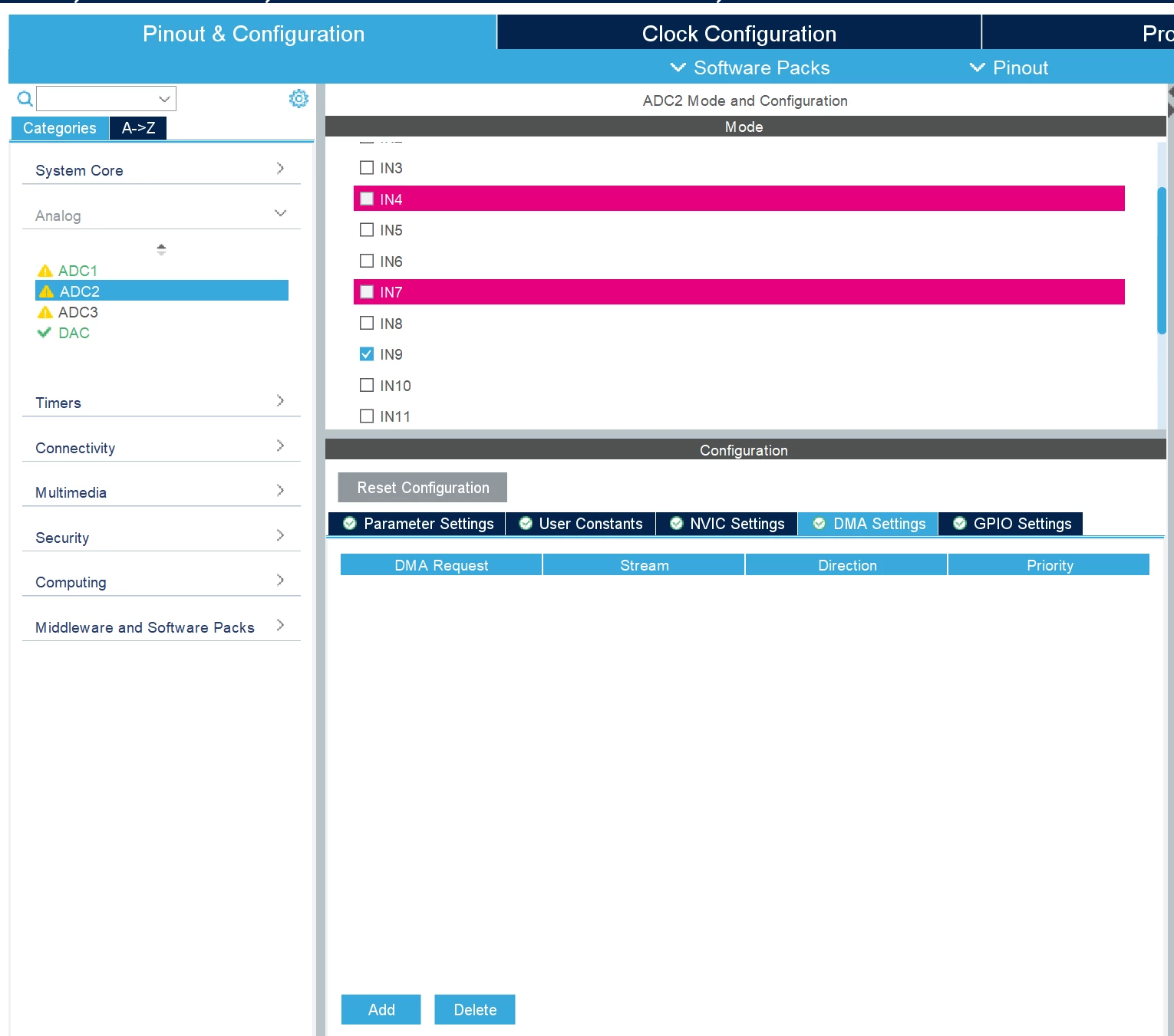

/* ADC2 init function */
void MX_ADC2_Init(void)
 /* USER CODE BEGIN ADC2_Init 0 */
 /* USER CODE END ADC2_Init 0 */

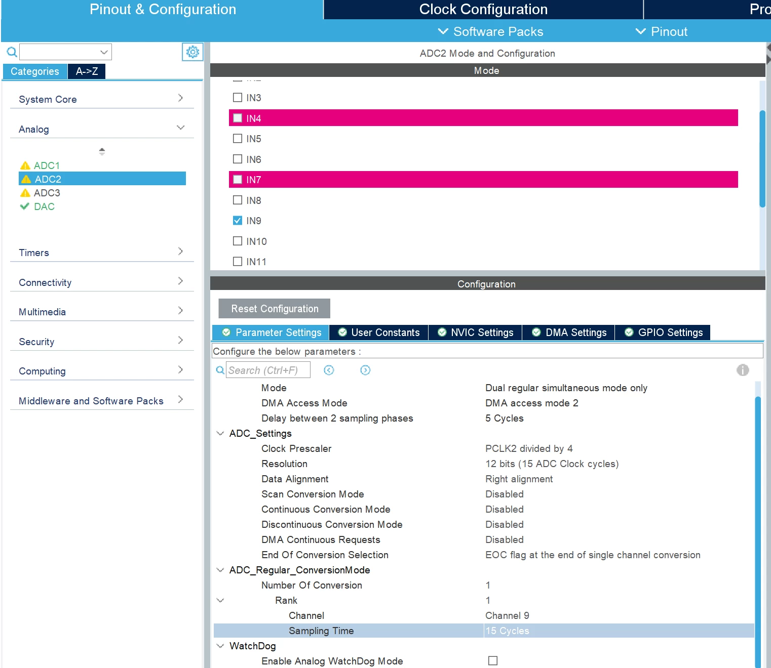

 /* USER CODE BEGIN ADC2_Init 1 */
 /* USER CODE END ADC2_Init 1 */
 hadc2.Instance = ADC2;
 hadc2.Init.ClockPrescaler = ADC_CLOCK_SYNC_PCLK_DIV4;
 hadc2.Init.Resolution = ADC_RESOLUTION_12B;
 hadc2.Init.ScanConvMode = DISABLE;
 hadc2.Init.ContinuousConvMode = DISABLE;
 hadc2.Init.DiscontinuousConvMode = DISABLE;
 hadc2.Init.DataAlign = ADC_DATAALIGN_RIGHT;
 hadc2.Init.NbrOfConversion = 1;
 hadc2.Init.DMAContinuousRequests = DISABLE;
 hadc2.Init.EOCSelection = ADC_EOC_SINGLE_CONV;
 if (HAL_ADC_Init(&hadc2) != HAL_OK)
 Error_Handler();
 sConfig.Channel = ADC_CHANNEL_9;
 sConfig.Rank = 1;
 if (HAL_ADC_ConfigChannel(&hadc2, &sConfig) != HAL_OK)
 Error_Handler();

 /* ADC1 DMA Init */
 /* ADC1 Init */
 hdma_adc1.Instance = DMA2_Stream0;
 hdma_adc1.Init.Channel = DMA_CHANNEL_0;
 hdma_adc1.Init.Direction = DMA_PERIPH_TO_MEMORY;
 hdma_adc1.Init.PeriphInc = DMA_PINC_DISABLE;
 hdma_adc1.Init.MemInc = DMA_MINC_ENABLE;
 hdma_adc1.Init.PeriphDataAlignment = DMA_PDATAALIGN_WORD;
 hdma_adc1.Init.MemDataAlignment = DMA_MDATAALIGN_WORD;
 hdma_adc1.Init.Mode = DMA_NORMAL;
 hdma_adc1.Init.Priority = DMA_PRIORITY_LOW;
 hdma_adc1.Init.FIFOMode = DMA_FIFOMODE_DISABLE;
 if (HAL_DMA_Init(&hdma_adc1) != HAL_OK)
 Error_Handler();
 __HAL_LINKDMA(adcHandle,DMA_Handle,hdma_adc1);

1 reply
KnarfB
June 10, 2025
For small Timer_Clock  and high sample_rate, (uint32_t)(Timer_Clock / sample_rate) will be zero. Subtracting 1 yields an overflow because of unsigned, which results in a huge number. This may effectively stop your ADC capture.
hth
KnarfB
