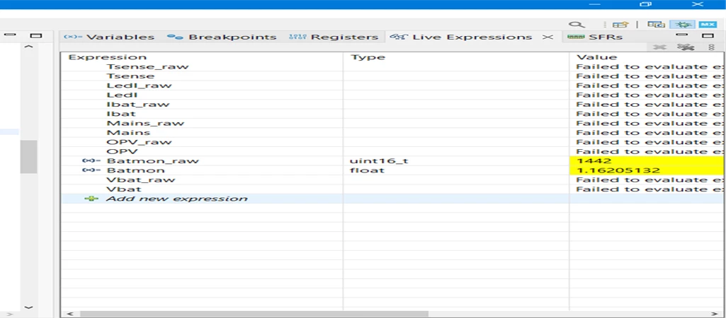

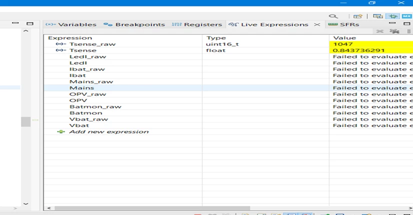

ADC_Reading same values
I have programmed STMG030k8T6 MCU in a prototype
Channels used ADC_IN_0 as T_sense  ADC_IN_15 AS BattMon
if I am calling any one of the function I am getting exact values what i measure in hardware
But if i called them both only reading values from CH 0 please help me to sort it out stuck for  a long in this
Note:When i used conversion with DMA ,also getting the same issues
Reading channel_0
reading channel_15

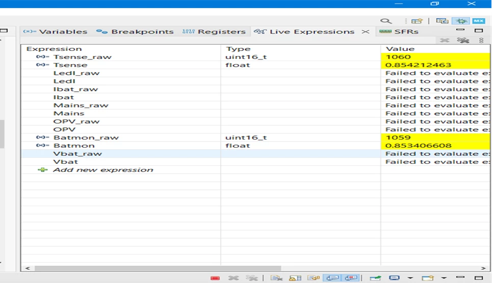

but when read both
Already I have tried maximum of suggestions by the people but still struggling to get the solution

When you configure the second ADC channel, the settings from the first channel are already in there.
In the previous thread, I suggested checking the ADC_CHSELR. Did you do so? What is the value of this register in each of the three cases? Use that info to guide the solution.
If that doesn't solve it, print out the ADC register values in all three cases just prior to the HAL_ADC_Start call and someone will surely spot the issue.
Three cases are:
  • Converting ADC_IN_0 only
  • Converting ADC_IN_15 only
  • Converting ADC_IN_0 first, then reconfiguring to convert ADC_IN_15

I solved by setting ADC_CHSELR Thank you so much for the help.
