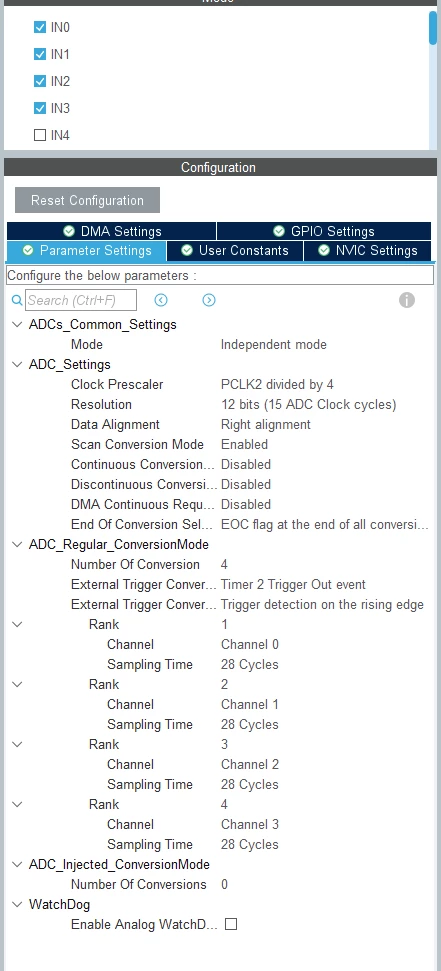

I'm using an STM32F427VIT6 and I need to read the analog values of 4 different channels (PA0 - PA3).
Since I need to calculate the RMS value of the measurement and i need the data points to be evenly spaced in time I decided to do use DMA and trigger the conversion using a timer.
- Configured the ADC in Scan Conversion Mode
- Set it 4 Conversions and changed Rank 1 to Channel 0, Rank 2 to Channel 1, etc...
- Set it to 28 Cycles per conversion
- Set it to be triggered by the Out event of TIM2

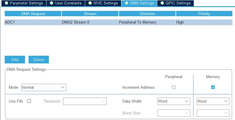

Then I enabled the DMA of ADC1 to be in normal mode, I want to do a bunch of conversions at a time but only when I fire them, not all the time.

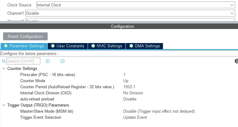

Then I configured TIM2 to fire at the rate I want. I decided I want to store around 200ms of data using around of 128KB of buffer, because that's like 65% of my ram.

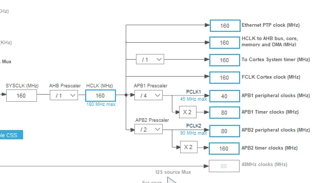

I may have calculated wrong, but the timer clock is 160Mhz with a Prescaler of 1 and a Counter Period of 1951 I get a frequency of around 41Khz

current and halfVoltage (offset 0 and 2) are perfect, very stable always read the same.
voltage and reference (offset 1 and 3) oscillate between 2 vales. One is the correct value and the other is incorrect, but always the same.
For voltage It's 2118 (correct value) and  2538 (wrong value). In addition, every time I start a new debugging session it starts with the incorrect value and then every break point it alternates one and one.
Some things I tried:
  • There is no electrical instability, I already measured and there is no voltage oscillation.
  • I added a big delay after the DMA call, to be sure I'm not reading the buffer whilst writing
  • I increased the sample cycles to 144 to be sure is not reading instability
  • I added a HAL_ADC_Stop_DMA(&hadc1); after the DMA is done to make sure it stopped.
NOTE:
There is one thing that helped. When I changed End Of Conversion Selection to EOC flag at the end of all conversions in the configuration of the ADC. It became more stable, reading correctly maybe 6 out of 10 times, now it oscillates between 3 values, 1 correct and two wrong.
Any ideas why this might happen?

Karl Yamashita
Nov 26, 2024 2:03 AM UTC
Try setting the DMA to Circular mode and enable DMA Continuous Request
If a reply has proven helpful, click on Accept as Solution so that it'll show at top of the post.CAN Jammer an open source CAN bus hacking toolCANableV3 Open Source
