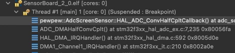

The ISR does get called and the calling stack clearly shows that DMA is called properly:
However, the result buffer which should be filled with 5 x 32 bits of data is left untouched.
Fun fact: Calling HAL_ADCEx_MultiModeGetValue(m_hadc_master) in the ISR does give me the last result.

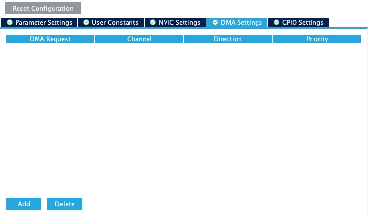

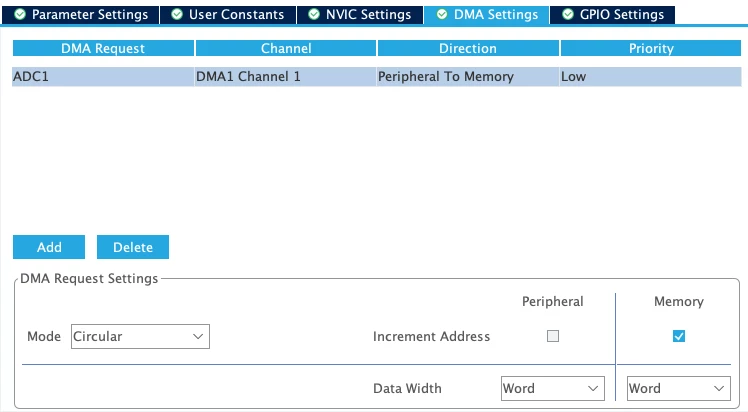

DMA settings for ADC1 are...
...and DMA settings for ADC2 are empty, so only one DMA channel is used:
I'm lost and the HAL documentation regarding dual regular simultaneous mode is almost non-existing. Any ideas ?
